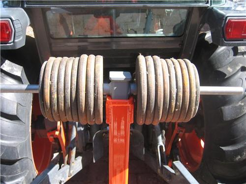

It has a good angle when lowered right down. It is working well with the weight. Just need to add some barbell weights LOL
   / Need more down pressure on my 3PL for a Ripper #18
That would be easy to do, drill your upright for the bar:
#19
Exactly! I often see stuff like that sitting on sidewalks that folks are trying to get rid of so I will grab some one day. 30 - 40 kg would be just right. I only have 20 kg at the moment but it is working.
