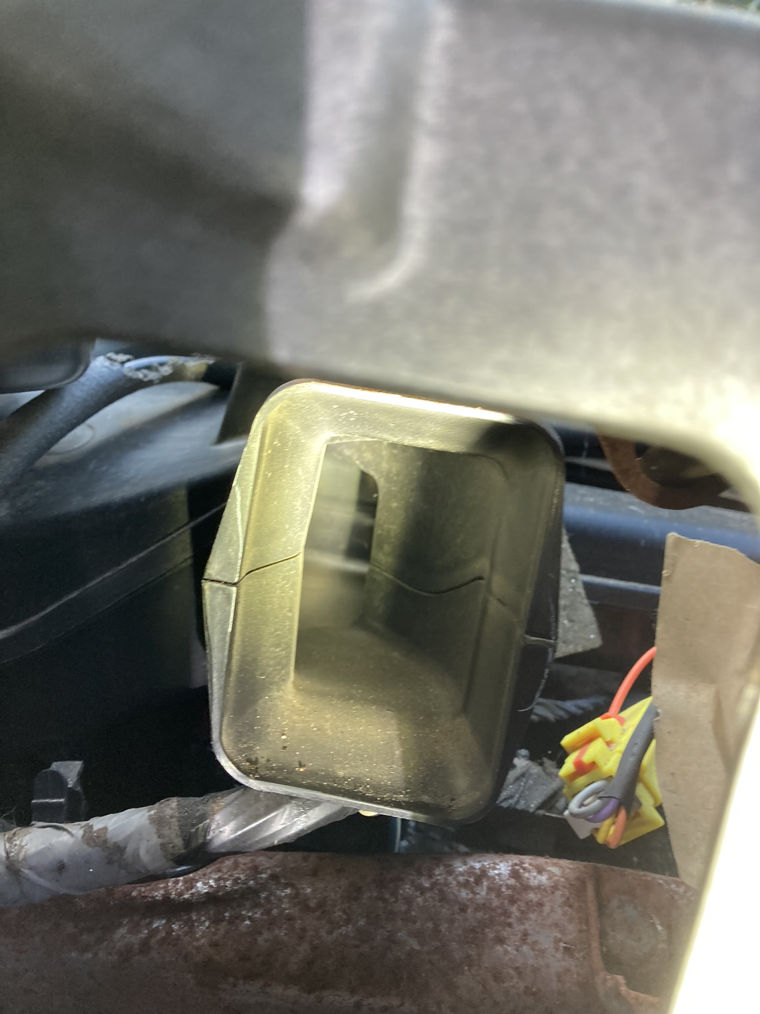

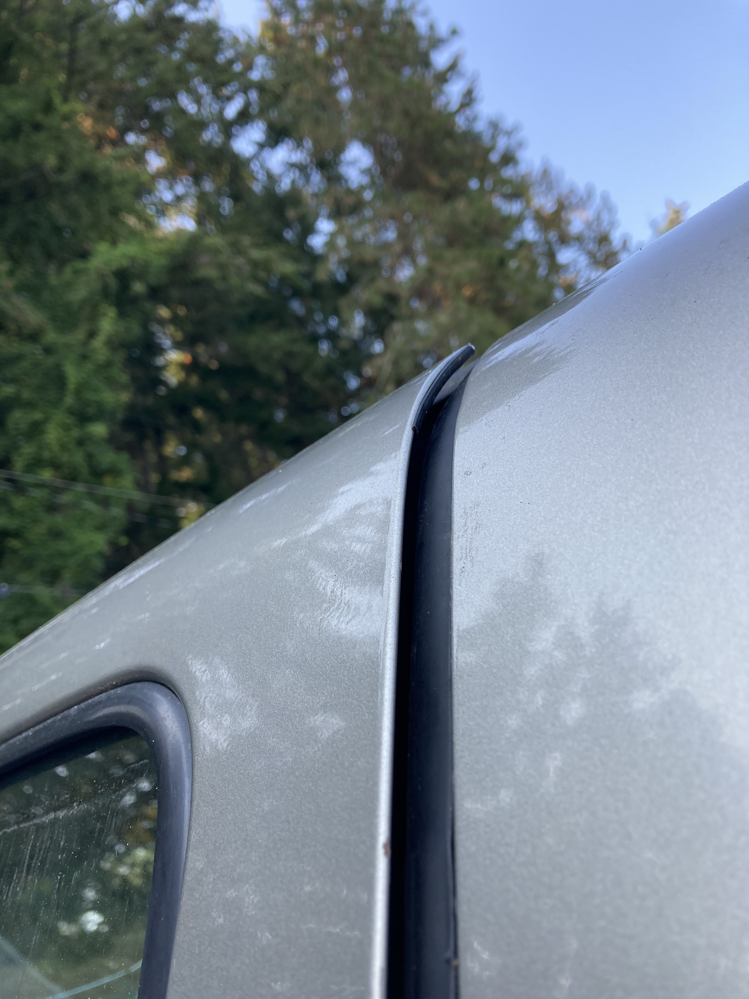

I am still not finding evidence of mice in the HVAC ducts, they look clear as far as I went. The mice were behind the vent controls and in a few other places as well. I think I will put the blower back in and flip it to high speed and see if I smell anything or hear anything. All the vent openings look like those pictured, no droppings. Sure is a lot of rust but no evidence of chewing on wires.
   / Need opinions 2016 Chevrolet 2500HD #132
Try running an ozone generator for a few hours with the heat/ac on recirculate. May take a couple rinse repeat cycles. Don't be in the truck while its running and making ozone. I did that with a 2011 that had mildew issues due to a roof leak, & it cleaned up the smell pretty good. A container of baking soda under the back bench seat for a few months may finish up the smell cleanup. Check the area around your high center brake light real carefully. I had rust through problems in that area on both a 1999 and 2011 silverado 2500.

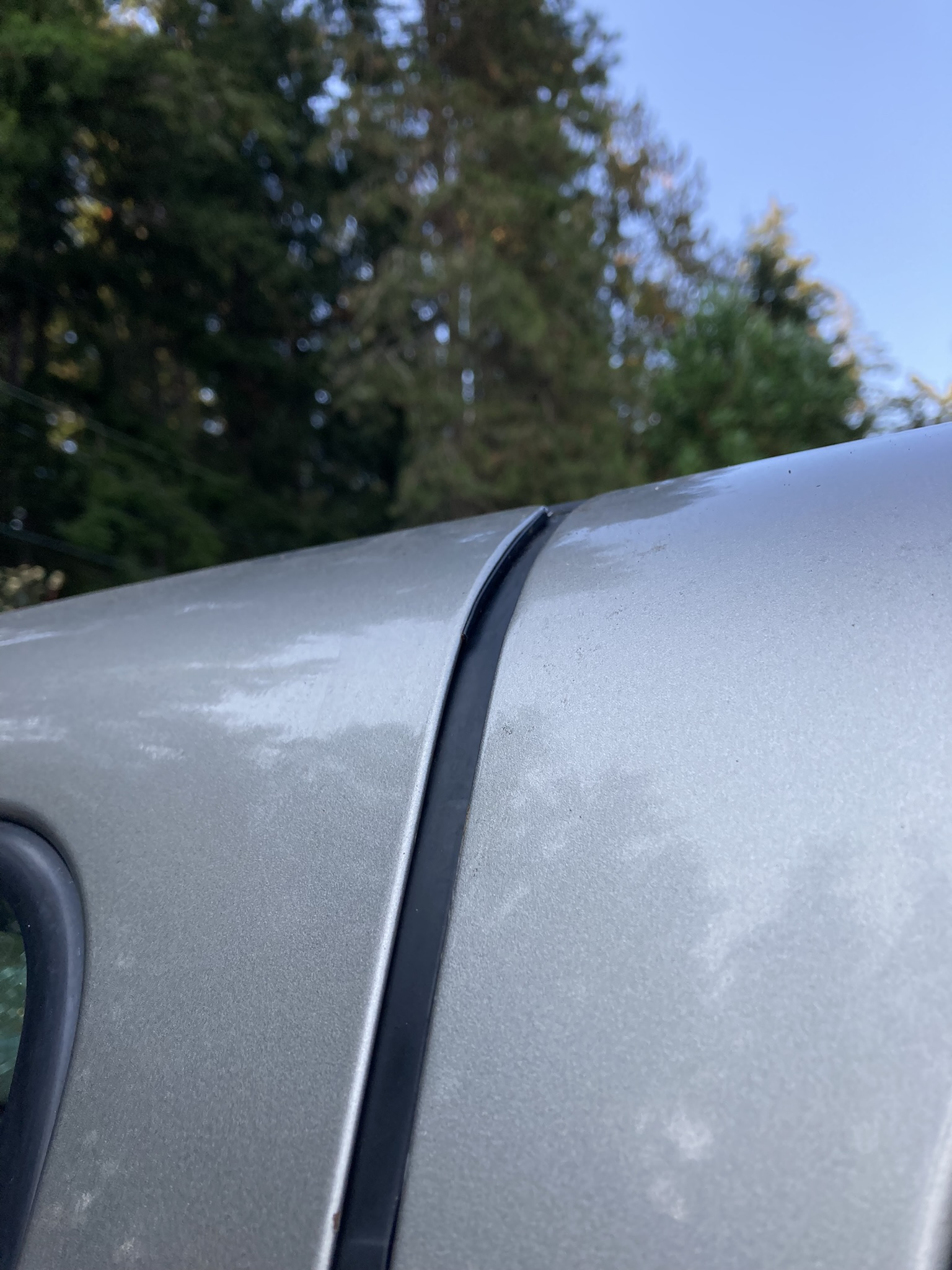

   / Need opinions 2016 Chevrolet 2500HD #135
Its actually "graphite metallic" and really a dark grey/ black, but it was just waxed in that pic so it's reflecting the blue sky well. Looking forward to seeing how yours cleans up! Might need to claybar yours and give it a couple coats of wax.

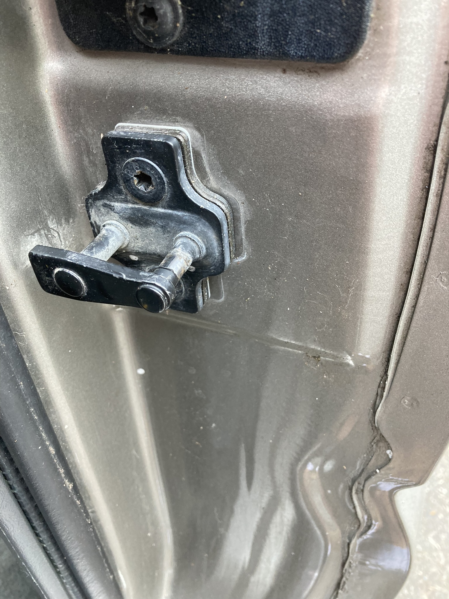

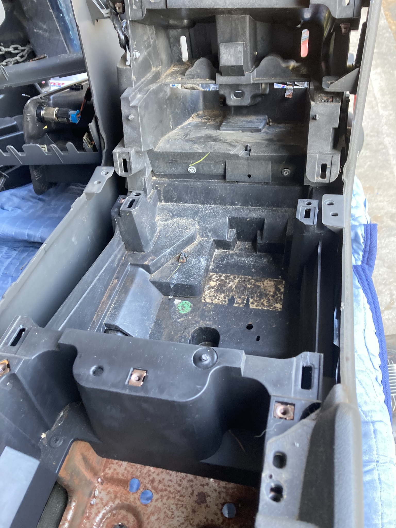

I got the center console apart today for a deep cleaning since the mice seemed to be using it as a hotel. I did not see evidence of chewing on wires in the console. Since the "feet" of the console are visible when inside the truck I am cleaning the rust off (Kleen Strip Metal Prep) and will paint them with black Derusto Before going back in the truck. I think I located part of the moisture light rust problem. Simple adjustment of the door strike. I think I am going to like this truck.

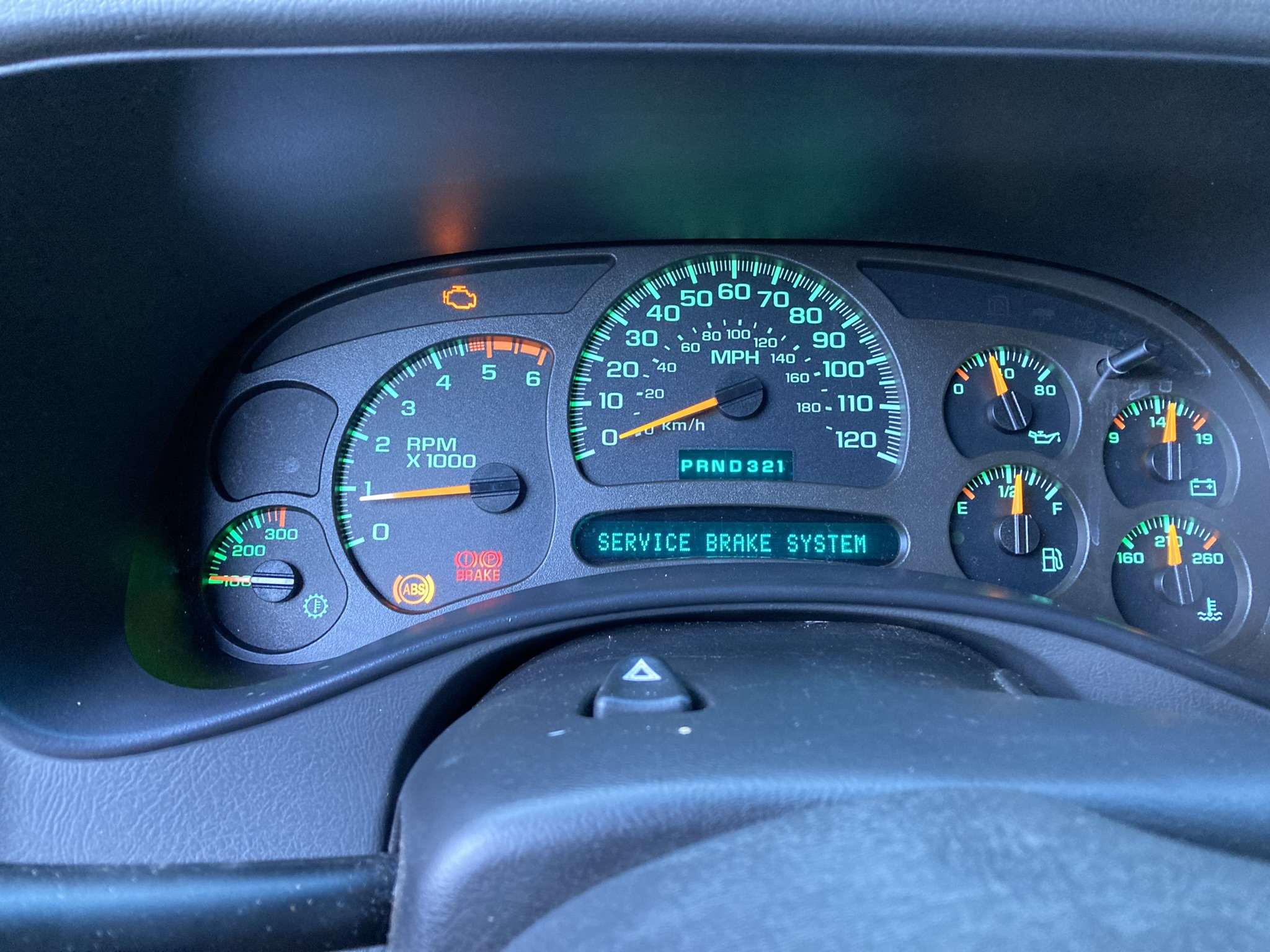

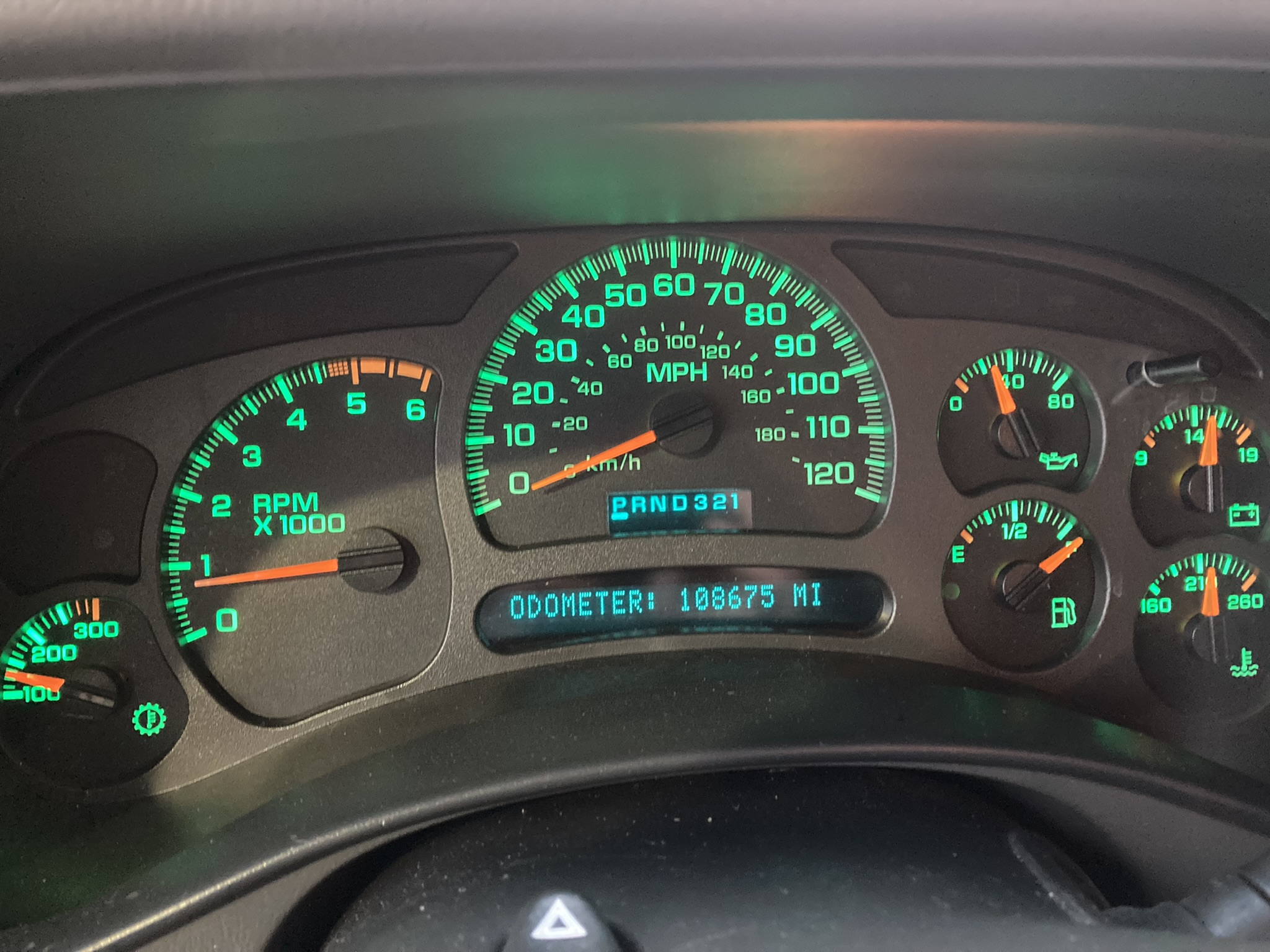

I got the interior put back together and took delivery of my repaired dash cluster. It does not tell me what position the transmission is in, but I can live with that. Looks like brakes need attention.
   / Need opinions 2016 Chevrolet 2500HD #138
Well I finally have a clear dash cluster. Problems were a bad transmission speed sensor and bad Transmission Control Module. Why the dash showed brake problems, I may never know. Now I can safely drive it and get it to a truck scale.
