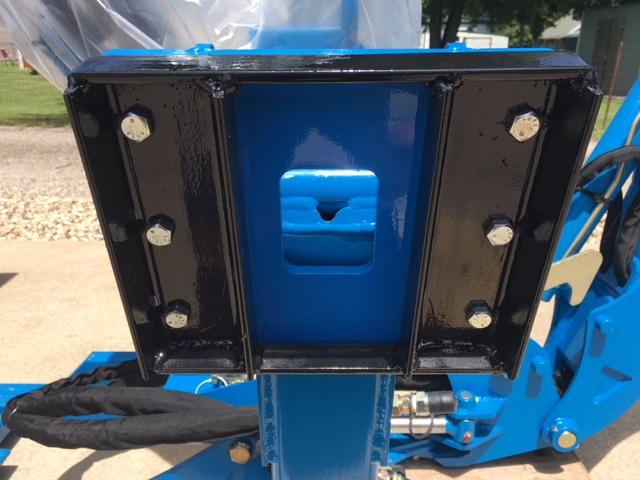

I recently purchased an LS backhoe for my XR4046. I really like the subframe mount. I looked at 3pt. mounts but opted to go with the subframe. I think the LS subframe will be much easier to put on and take off. Not that I have much warranty left but I would check and see if a 3pt. would alter the warranty or not. LS only offers rubber stabilizer pads which are pricey (around $200 per 4) and seem to not hold up very well. For less than $40.00 I made a set. I got the idea off a youtube video that shows how to build them. I am by no means a great welder but I get by. thumbnail.jpg
