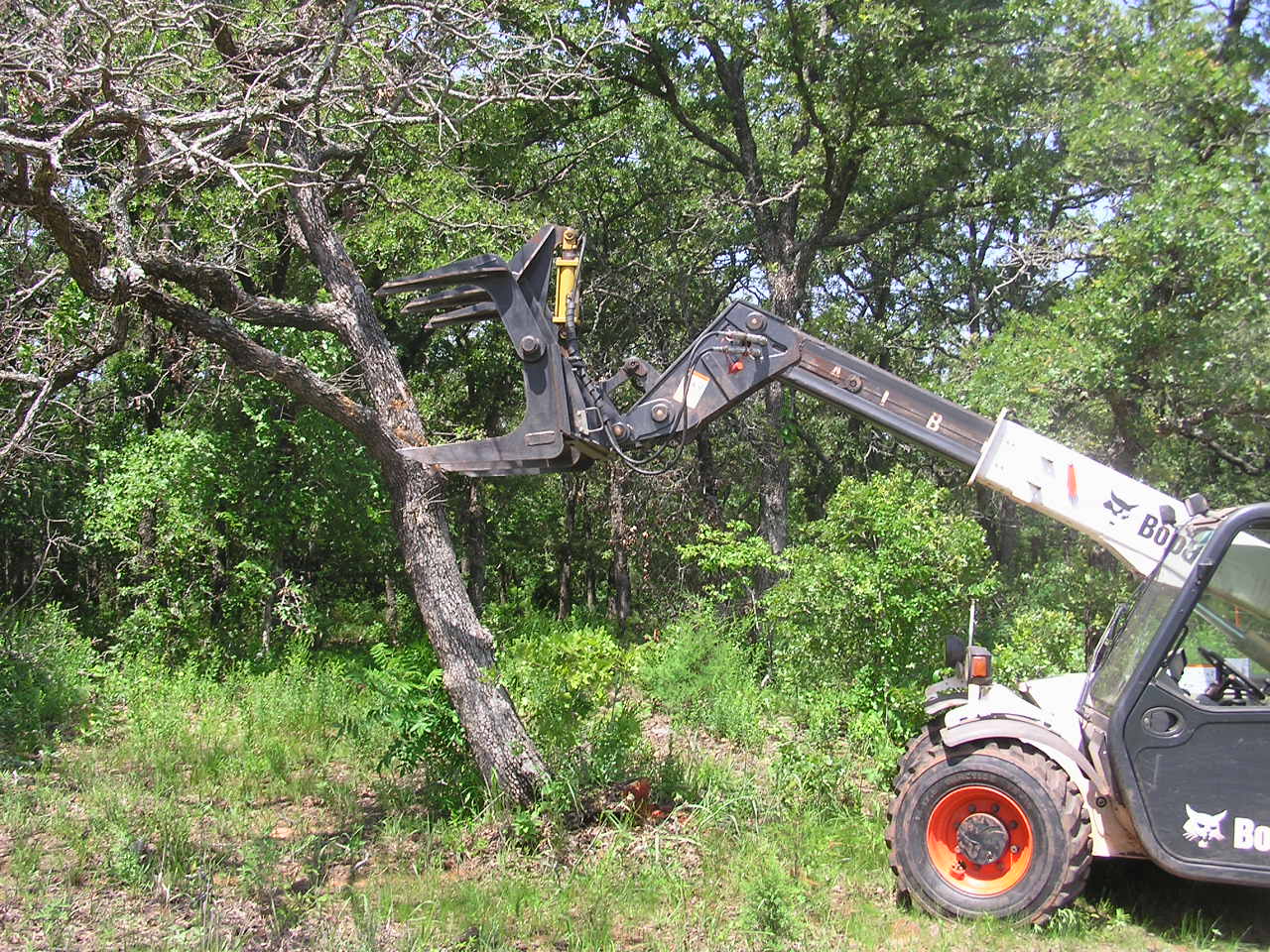

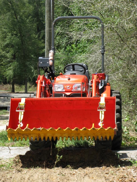

When you are ready to push on the trees be aware that a Ratchet Rake attached to your bucket will give you a great deal more purchase on the trees. Also a useful tool for consolidating tree debris.
VIDEO: https://www.youtube.com/watch?v=A2kNTv2JD5s
