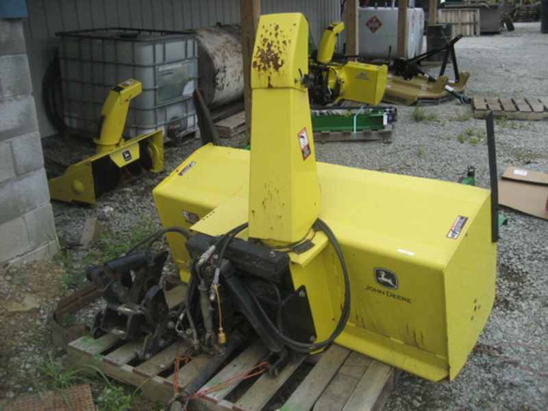

I did some looking around on the web and found this picture of a 59 off of a 3320:
I can say that this is nothing like the lifting setup for the 55 series. I believe that V8 has been fed some misinformation from his counter guy. I'll have to get a picture of mine the next time I'm out in the barn and post it up for comparison.

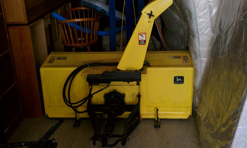

EDIT: I found this picture of the x55 series setup (which looks like mine).

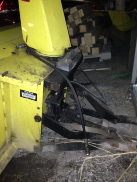

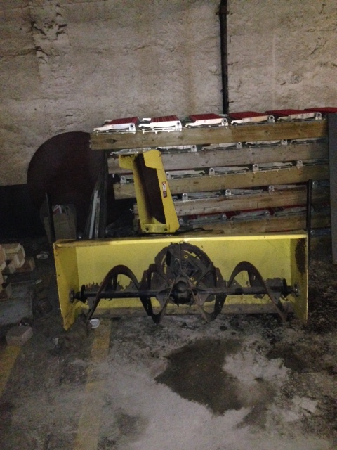

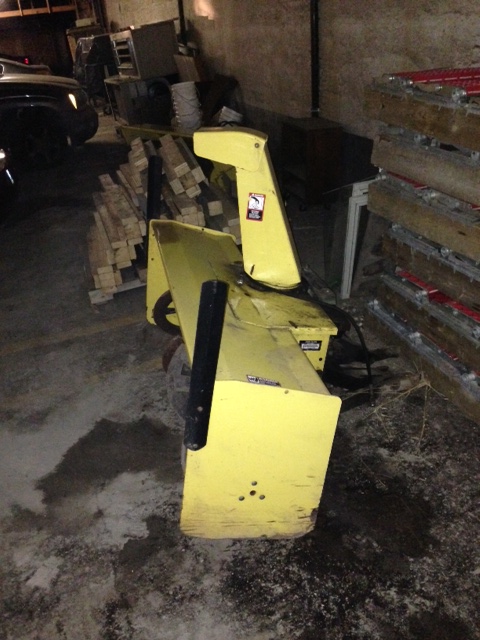

   / need parts gurus fast help JD blower fitment
see pictures.
