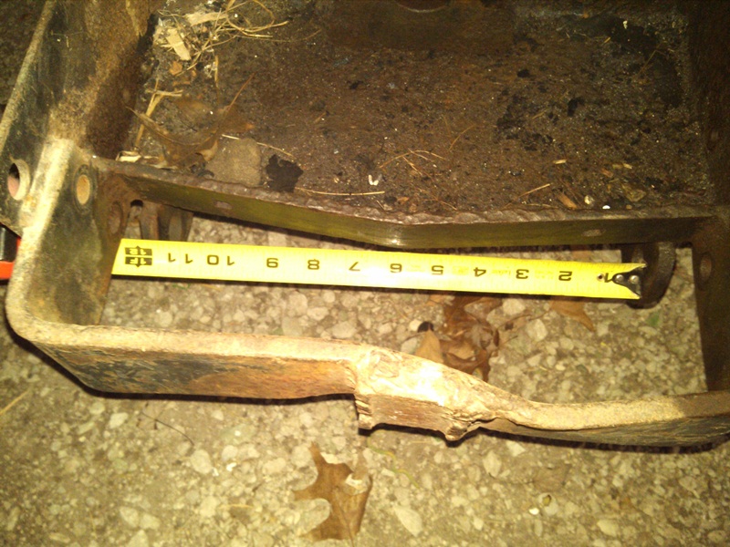

Looks good. I question that it came off of a 3320, as the lifting mechanisms in your pictures show the 855/955, 670/770, 790, 3005 style mount.
V8, I saw the attaching bracket you'll need listed on ebay the other day. It was just the bracket minus the short little PTO stub shaft.
   / need parts gurus fast help JD blower fitment
#12
Yea after seeing your photo i also question that it came from a 3320. Before i went to go look at the unit I knew what the brackets should look like to fit the 55 series so when i saw the lifting arms on this guy i scooped it up.
Ill look for the bracket, what should i search X55 front bracket?

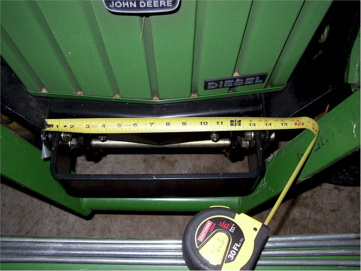

Search it by part number "AM106975" Also, I noticed there is a mid-to-bracket PTO shaft listed as well. Search "755"
One other thing I'm curious about... is the width between the frame rails on the 755 the same as the 955? The width of the bracket for the 955 is 11.5"

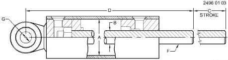

Mechanos,
can you measure your hydraulic lift cylinder for me.
Bore dia:
Stroke Length:
Retracted length: pin to pin
Pin hold diameter:
Id like to get a generic lift cylinder instead of the JD one as they want $300.00 for it

Mechanos,
Bore dia:
Stroke Length:
Pin hold diameter:
Does this help?
Specification
Weight 6.64 LBS 3.01 Kg
Bore Diameter 2.500 IN
Rod Diameter 1.000 IN
Stroke 4.250 IN
Closed Length 9.842 IN
End Type-Rod & Cap 0101
Rod End Size 0.516 IN
Cap End Size 0.516 IN
Working Pressure 1,999.999 PSI
Inside bracket width on 755 is also 11.5 inches. Outside frame dimension is 14 inches.
