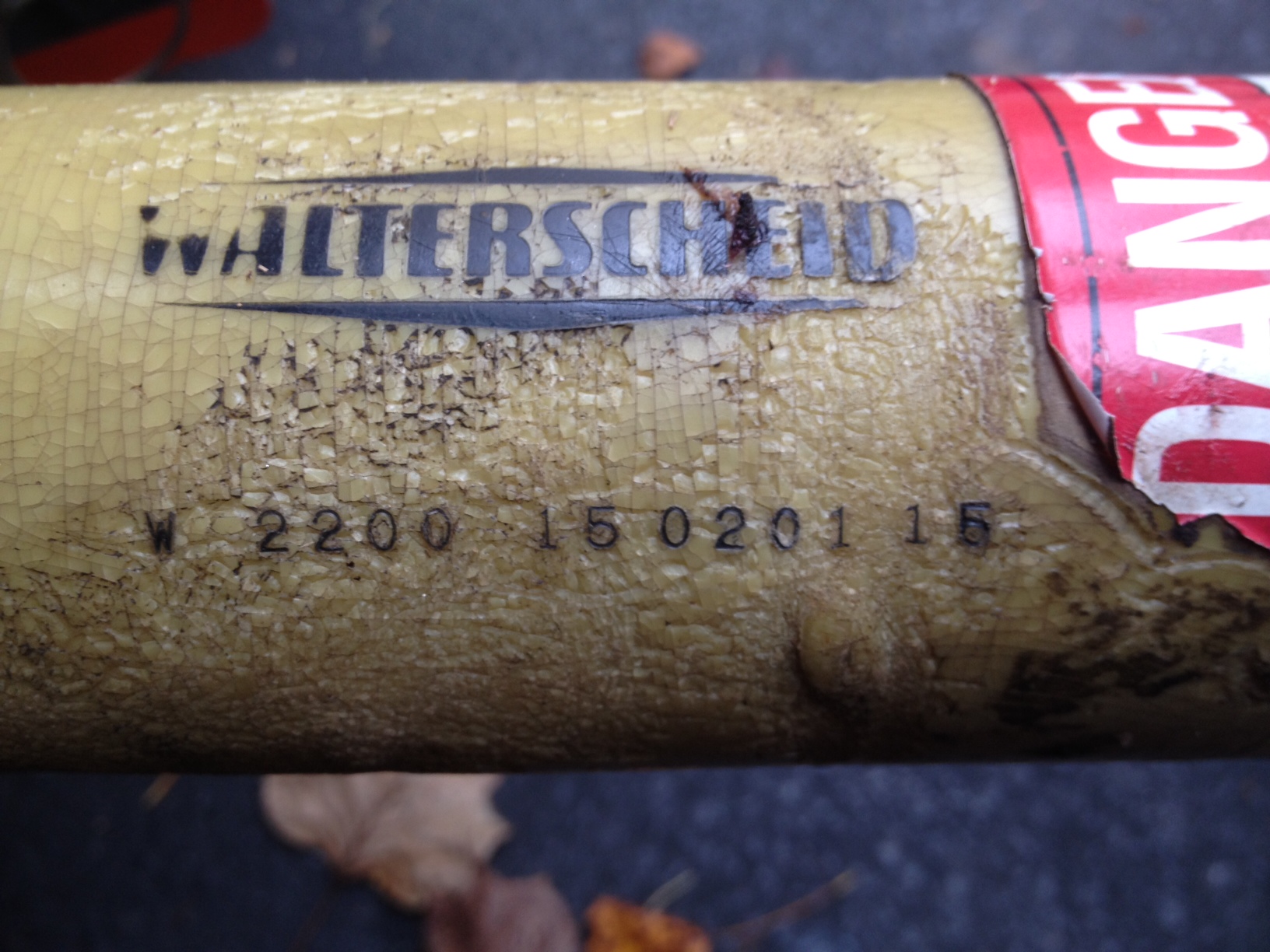

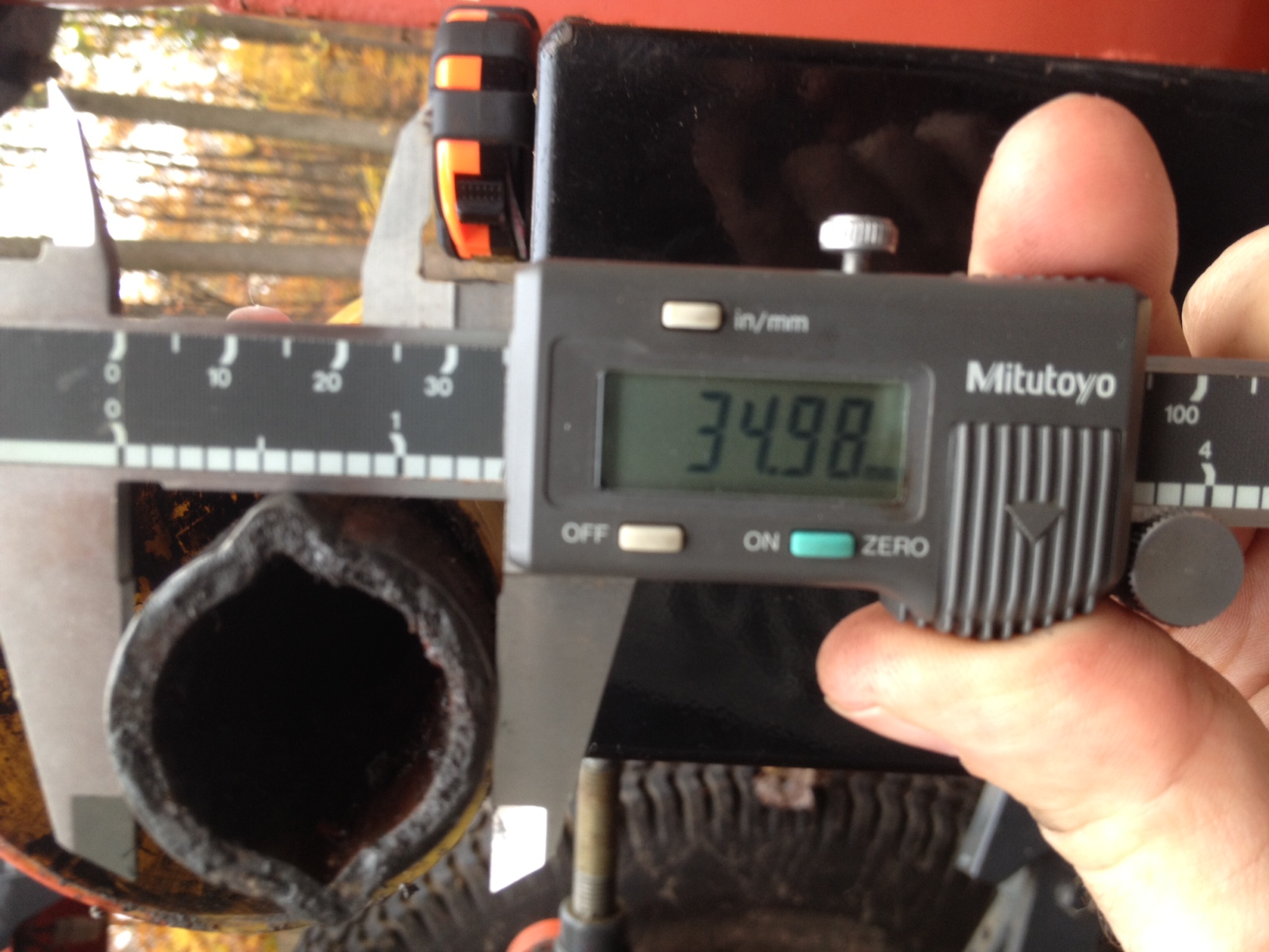

Pineridge,
PaulB's has this helpful chart to determine which PTO series you have.
http://resources.paulbparts.com/resources/determining-your-pto-series.pdf
The shape and dimensions of the inner tubes will go a long way in determining what you have. Also look for any type of writing or codes printed on the existing protective cover.
Here's what I was able to find one of my PTO shafts for reference:

Thanks for the link, looks like I'm Italian. :thumbsup:
