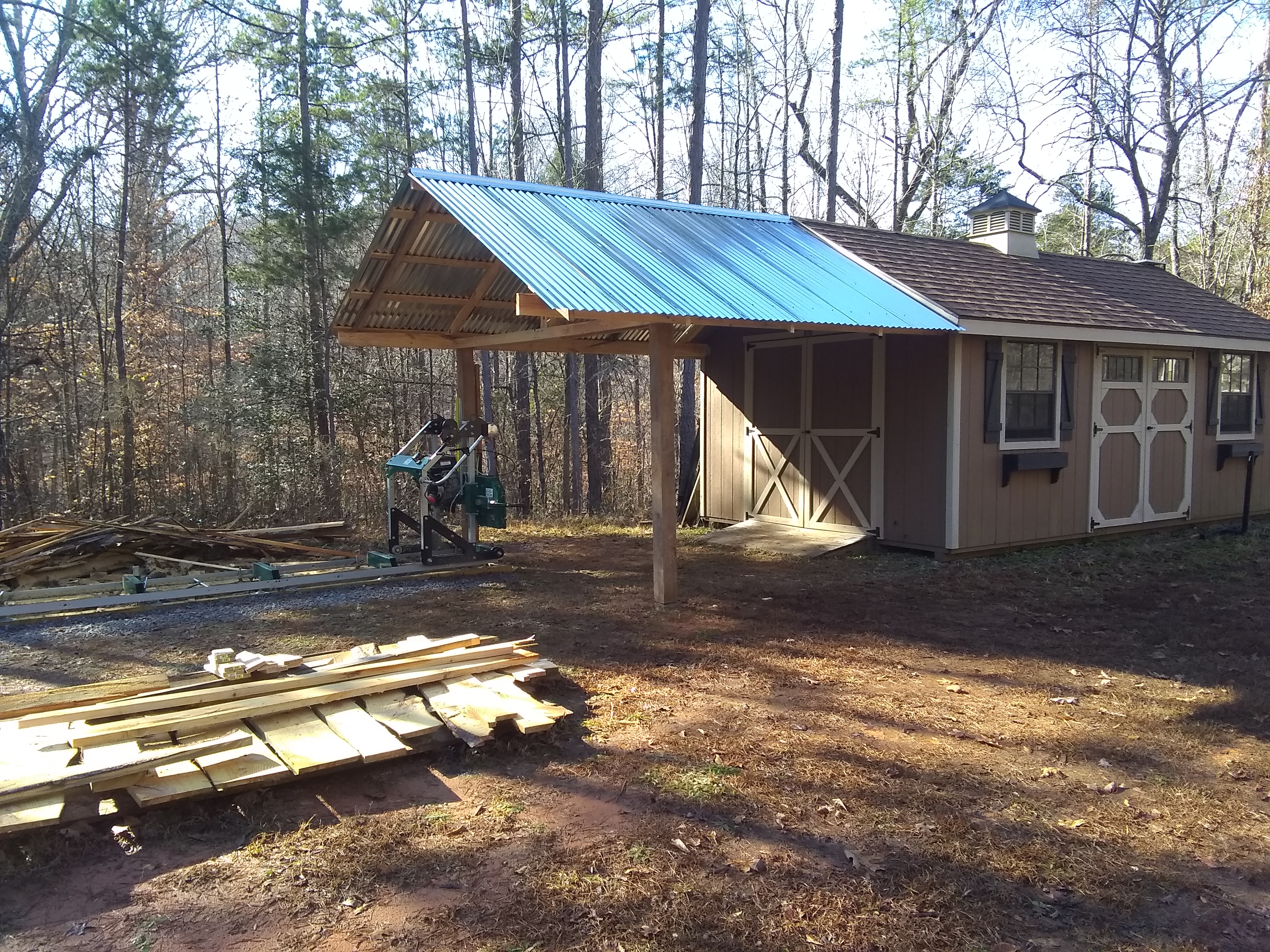

For log posts, I have poured concrete piers in the ground that stick above grade by 6" or so. I place a piece of 1/4" flat steel bar stock (about 2" wide or whatever I have laying around) in the wet concrete that sticks up about 8". Drill holes in the bar to help it anchor better in the concrete, or weld rebar across, etc. Then once it's set mount your posts on the piers and use a chainsaw (tip of bar) to carve a flat spot on the side of the post where it meets up to the steel bar. Drill holes and bolt it together.
I have thought about trying to cut a slot in the log with a plunge cut, so that the log could slide over the bar and hide it. But I think it might take a lot of extra time to get right and I hate wasting time (or money) just to get some use out of logs for posts when it would be faster/cheaper to use treated posts and commercial brackets. So I think the trick with using logs is to keep it simple and cheap, otherwise there is no advantage except for maybe looks.
I always put something under the end of the log to keep it from contacting the concrete directly. Could be steel, a piece of scrap plastic, whatever.
Very similar to what I had in mind.

Finally got around to finishing this project. I poured concrete piers for the posts, so the posts sit above ground level. I added a piece of 1/2" rebar to the piers during the pour, sticking up about 6" from the top of the pier. I center drilled the bottom of the posts with a 1/2" bit, and dropped it onto the rebar as an anchor. Had to hammer them down to make them fit down over the rebar, works well as an anchor.
All of the wood for the extension came from milling on the HM122. Great machine. Well made and enjoyable to use.
Added bonus: There's room for my Yanmar 2210 under the roof.

Nice job, looks like it was planned all along!
