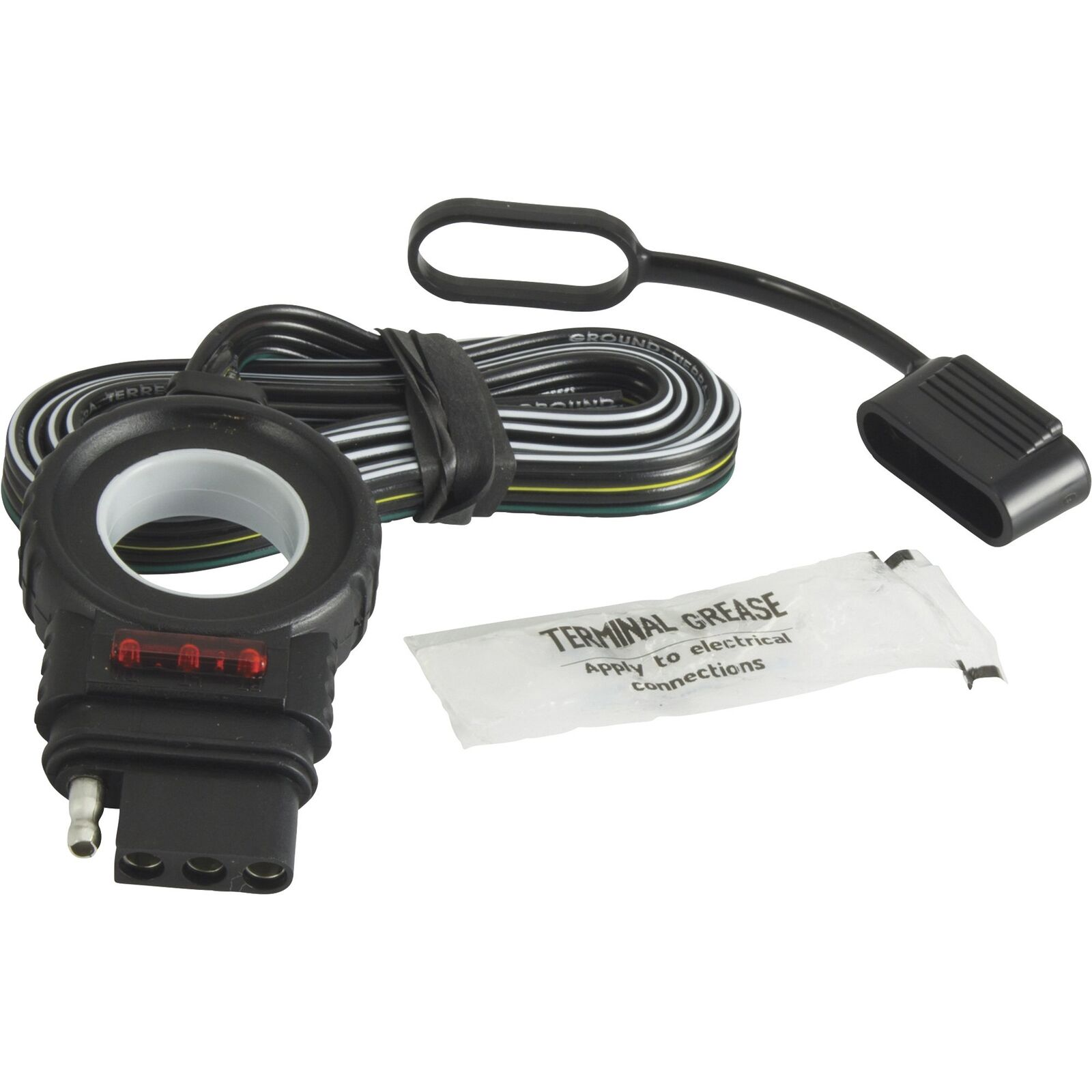

Something like this may be an option.
I’m not a fan of the pinch blade connections but it may be doable.

Stay away from the pinch blades. Had a former employee that loved those things. Created more headaches with trailer wiring is all it did
I just buy four flat plugs from the local auto parts stores with the 12" pig tails on them.
I splice them in with butt splices with the heat shrink.

I love these. In the process of changing all of them as needed. Both on the tow-er, and the tow-ee.
Have had a couple for a while and they seem very durable.

If I could find a do it yourself 4 pin connector that was quality I’d love to just make my own with automotive heavy gauge wires.
I may look into that as well.
a bit pricy, but deutsche connectors & heavier gauge wires for the connections/splices change over to a 7 pin for the main. My Kaufman came with wires that look about like lamp cord for most of the runs.
