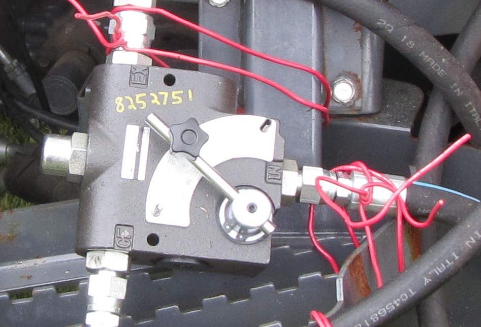

You can always put an adjustable flow valve in the circuit (the style with the third port that returns), I've done that in the past when building implements for a tractor that doesn't have an adjustable remote to run it.
   / Need recommendations for a hydraulic motor for a shredder/brush cutter conversion
Does it return to the tank?
   / Need recommendations for a hydraulic motor for a shredder/brush cutter conversion #8
I used a pressure compensated flow control for the hydraulic sickle mower on my Kubota M7040.
I have two lines coming from the rear remotes to the sickle mower.
The one line goes into the flow control and then back out to the motor.
The motor return line has a Tee where the flow control can dump flow. This line goes back to the rear remote.
I have a strobe tach and can adjust the flow to the motor to get exactly the rpm I want.
So to answer the question does it return to the tank the answer is yes but it does not need another line.
For $90 on eBay but available many places.
https://www.ebay.ca/i/173382010220?...bhZqFKmtDW8KklARqXg34eckSAGkBj4gaAkEQEALw_wcB
When you are operating something with a lot of inertia such as your cutter you should be using a control valve with a MOTOR spool. It differs from a valve normally used to control hydraulic cylinders which lock the cylinder when in the neutral position. A motor spool allows flow back to the reservoir when in the neutral position.
Another issue to include in your design is a way to protect the hydraulic motor is a blade hits something.
