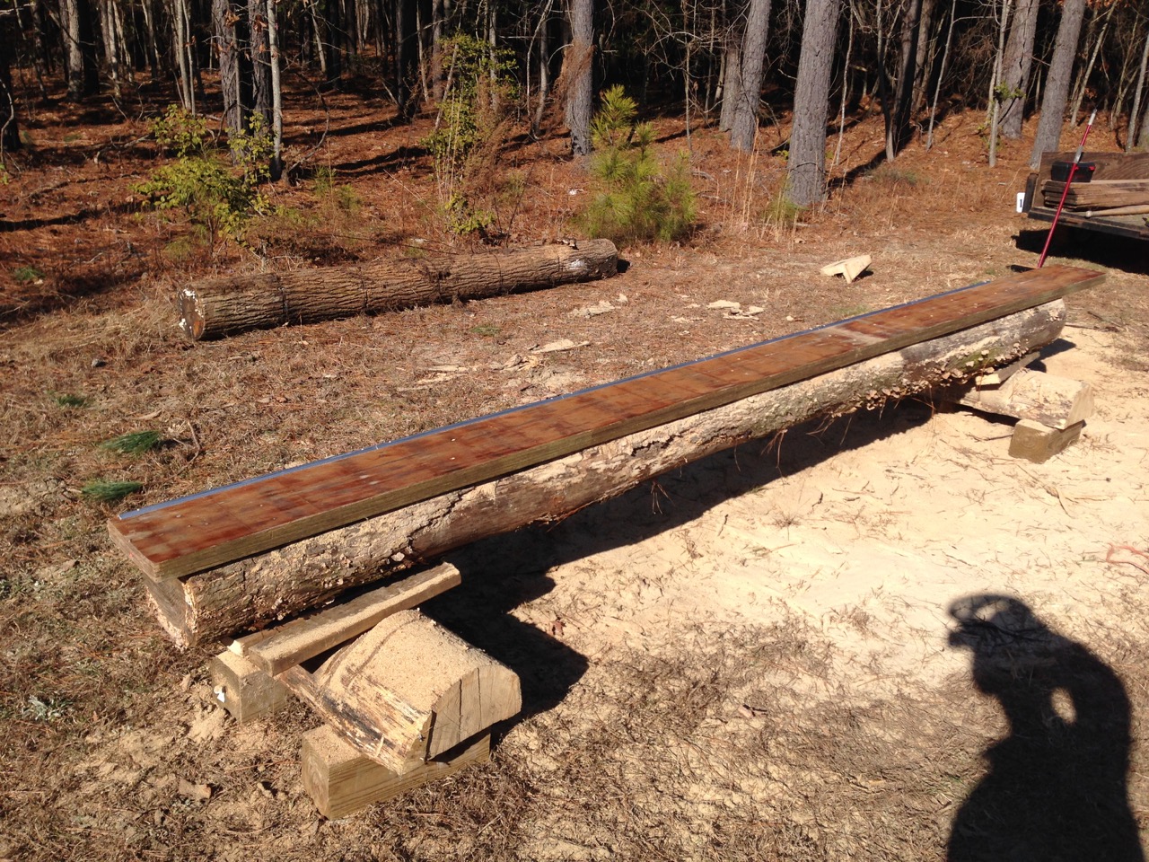

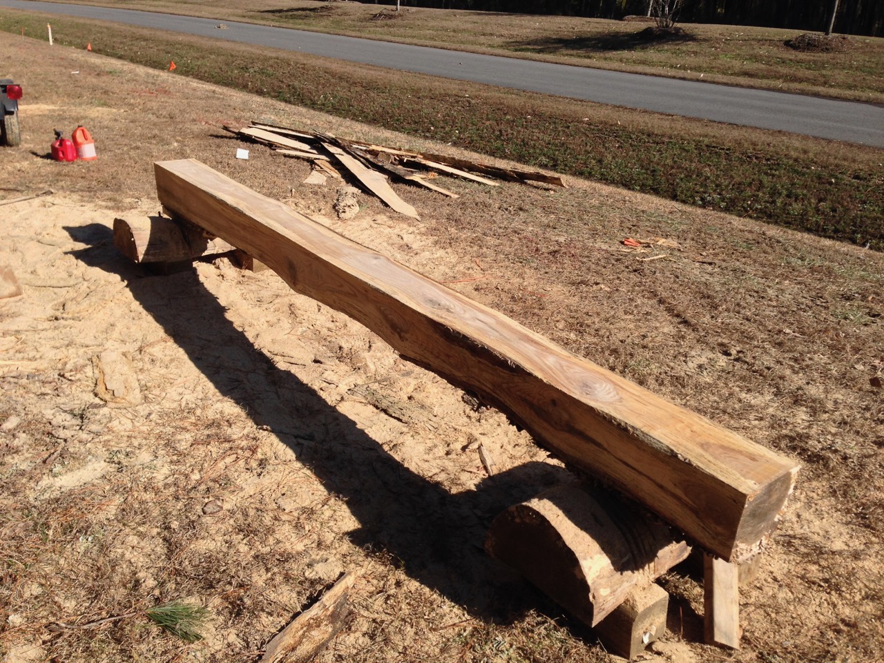

A 271 isn't even close to being a good saw for milling -- for one thing, not enough cooling or oiling, but it will definitely be down on power from where you want to be. I consider the Stihl 461 the smallest feasible saw for milling.
That said, be aware that slabbing up smaller trees will be a challenge because you're trying to perch the mill on the log. By the time you square up that size tree, you are probably talking about a 10-11" square. It will be unwieldy to run a 75-90cc saw with an Alaskan rig on such small wood. I have done it, but it's kind of like sawing on a toothpick.
For smaller wood, I like using my beam jig. I have a 2x12 LVL beam with the aluminum guide track on it, which I screw down to the top of the log, then run the saw down the sides. It works well. Makes nice beams, or does a good job squaring up the log before you cut boards with the slabbing jig.
Hemlock is some pretty wood and makes nice looking wood for interior paneling or trim, or posts/beams.
Here's a smaller oak log in the process of being squared into a beam:
