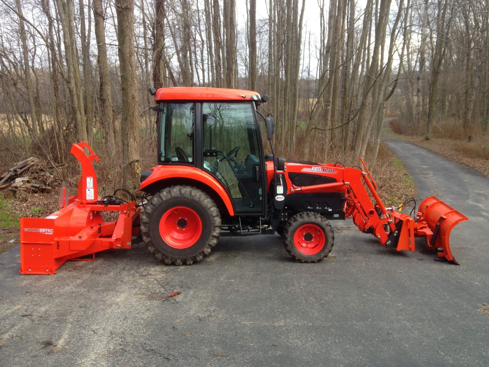

I have a DK35 with loaded R4's and was surprised how poorly they performed on dense snow. I think you will be happy with how much rear chains will improve your tractor's winter capability. I also have a pull type snow blower and find it perfect for my situation. Driving through the snow before the blower hits it is no different than doing the same with a pull type blade. The blower gets the snow that was slightly packed down.
I had a rear blade before the pull type blower. I had to offset the blade and push in reverse to get the snow far enough off the driveway so it did not eventually get too narrow. The twisting caused back problems. So I solved this by operating the blade by only pulling it and then would do one pass down and up my driveway with my 27" gas snowblower to get the piles into the bush, leaving room for the next time.
I clear a neighbour's driveway but had to quit for a year because my back could not take the twisting with the rear blade operating in reverse. Another neighbour would do the light snows with his quad but eventually I had to use the tractor and blade in reverse to push the snow banks back.
With the pull type blower I'm again able to do her driveway in a fraction of the time it took with a blade.
Whether you use the bucket, a blade, or blower, for clearing snow I think chains will be a good investment, especially for your conditions with hard packed snow most of the winter.

I have ds4510 which is a bit bigger but same principle when it comes to snow removal....loaded rear tires, rear snow blower, front blade, industrial tires which are not great in the snow....I considered chains on the rear tires but insufficient clearance between tire and fender so I installed chains on front only....that, by itself made a world of difference...I can plow as much snow as my 6.5' blade can handle....some people advise against front chains only but I see no problem with this....there is enough slippage with snow that it is not an issue as far as possible damage to drive gears...Kiotis have pretty beefy front ends.
