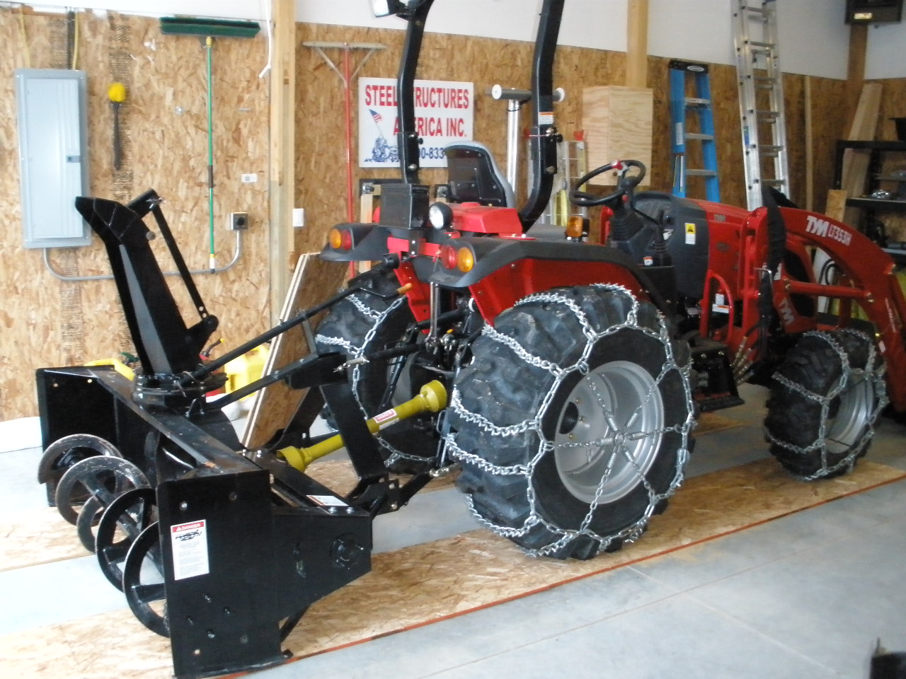

I don't know what your wheel clearance is like but I would check with my dealer for recommendations on how to run chains on your tractor. I run 4 link v-bars on all 4 of my R-4 tires, they do not fall between the treads for me as some mention. I have a hilly and at times icy driveway and road to work on. We average about 100" of snow at my elevation and I cannot handle that without the blower to move it away from the road. Here is a picture of the chains on my R-4's. 4 links do bounce a bit as you drive and it shows when I used my back blade leaving chatter marks on the hard packed snow. Tirechains.com were a pleasure to work with and the prices are competitive.

Where did you get the rear chain tensioners? (Tirechains.com) What model were they. Looks like the ticket to keep things tight
I got them from Tirechains.com, make sure you get the binder tool to help get them on. Sometimes I use a ratchet strap also to help pull the spring enough to hook the tension chain.
