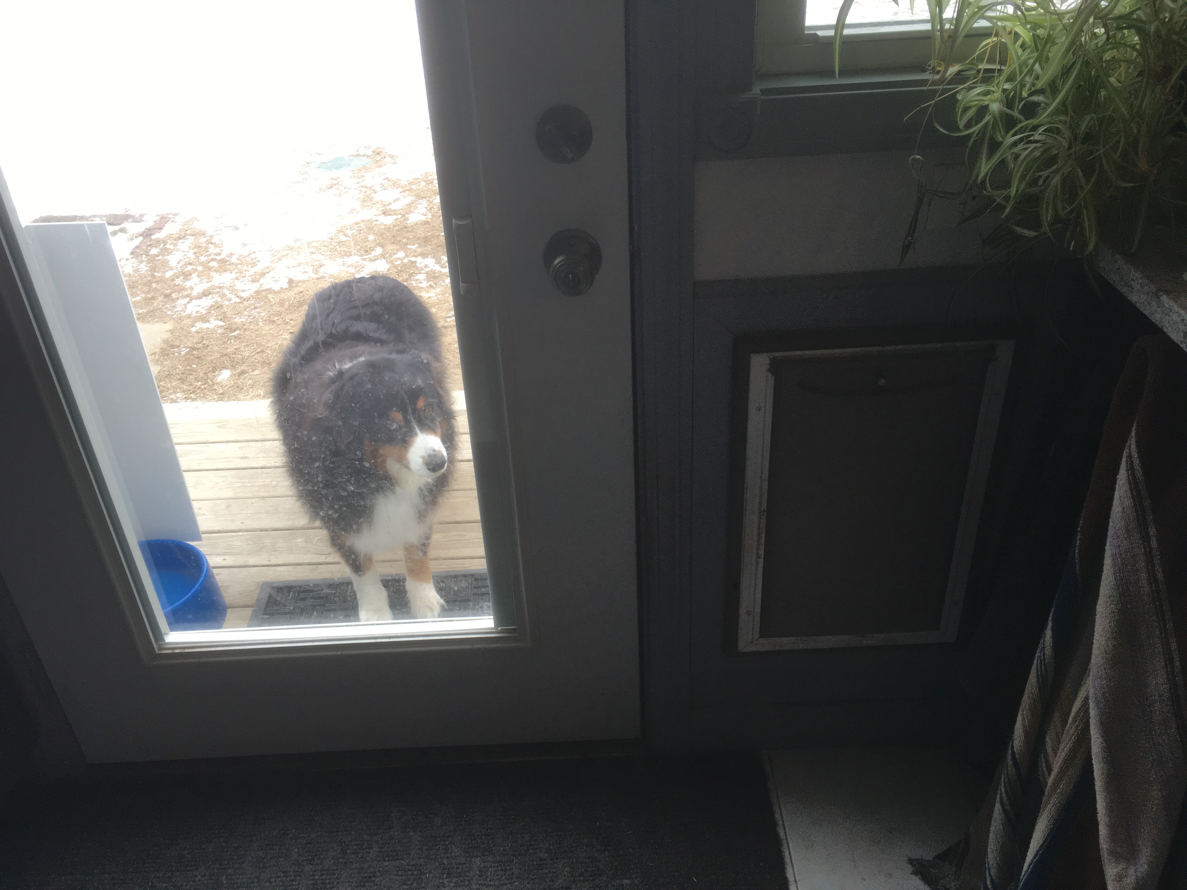

I replaced a 6' sliding door with a swing door and a smaller sash window. Inspector was fine with using the existing door header across the combined opening.
It looks like your existing header is supported with jack studs to make the rough opening. As long as whatever header you end up with is also supported, I don't see a problem with what you propose. One or two addition jack studs between the door and window would not be an issue. I will dig to see if I can find my framing pics.
   / Need some advise, cutting a block wall to install a door........ #17
Rough frame...
Note fill-in section to the left of the door. Also, the inspector was fine with removing 1/2" from the bottom edge of the header because the new door RO was that much taller than the slider. Wall plate rests directly on the header (7'8" walls) so there wasn't room to move it higher.
Trimmed out, went with a victorianesque style because it amused me.
Opening at bottom right is for a dog door. The end of the counter laps over the dog door a fraction.
Other end of the same wall we replaced a double window (much like yours) with a 5' french door, which leads out to an enclosed porch. While I would hesitate to use a french door on an actual outside wall since they have a reputation for not sealing well, there is another layer of windows and door (in fact, the same slider we removed above, since it wasn't that old). On very windy days, there is still a draft, so it seems ours are meeting expectations. :)
