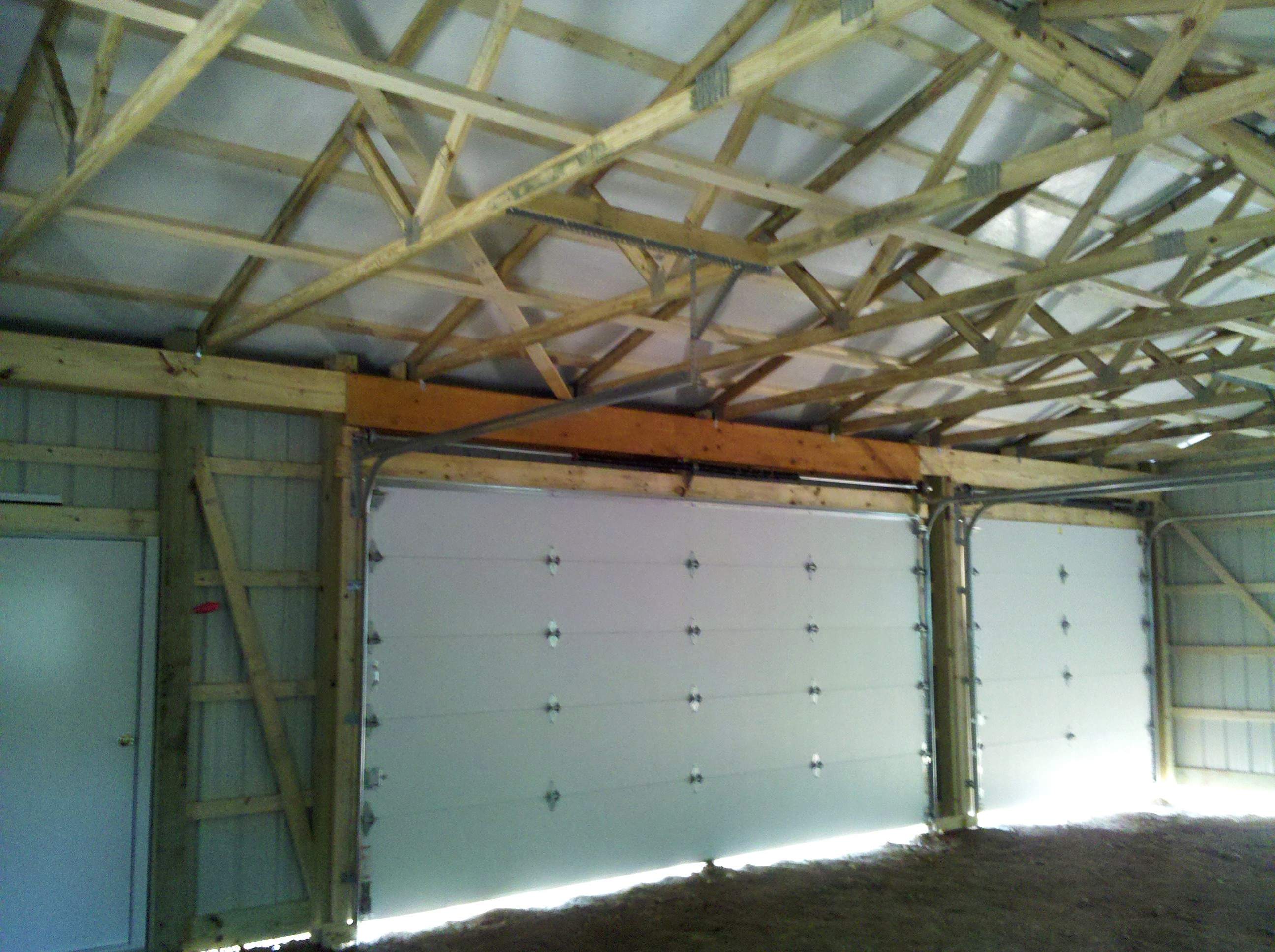

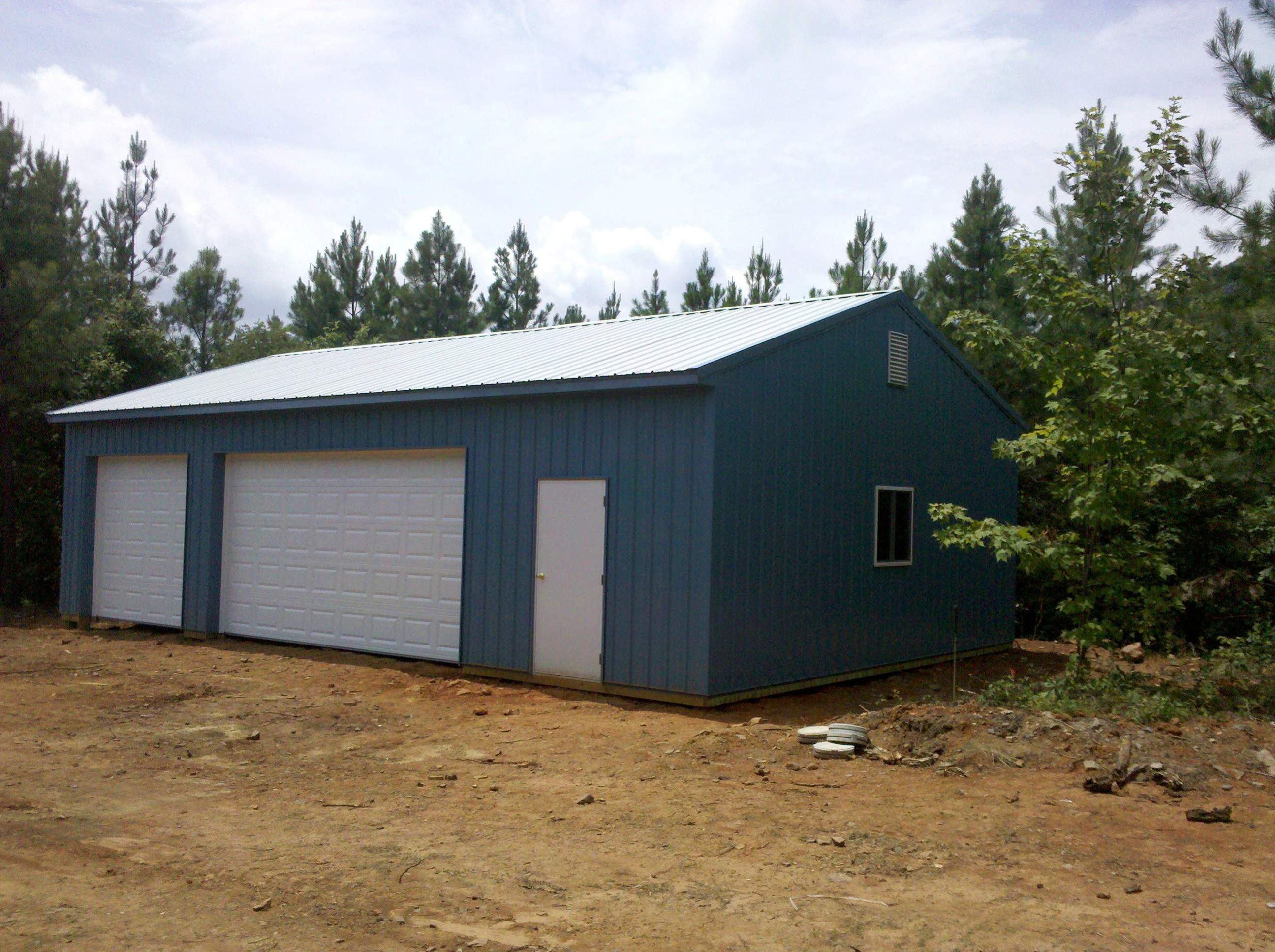

May I shift gears slightly and ask about "piping" thru this pad before I have it poured?
I'm planning on water into the building and a couple of faucets thru the walls and a deep sink(will need drain). No toilet as there is no septic nearby. (guess I'll get a marine port-a-potty). I figured that the deep sink could drain into the woods somewhere.:ashamed:
Also, I will eventually have electricity.....A meter hung on the outside wall, I guess. Would you suggest that this electricity come STRAIGHT thru the wall....or put a large gray conduit down the outside wall, UNDER the wall and up thru the concrete for elec. cable?
Anything else I might be missing before I have 'crete poured? Thought about a grilled drain line in the middle of the shop floor? the building is 24X40 with the right hand 10' being shop.
Any input is appreciated. Rob
