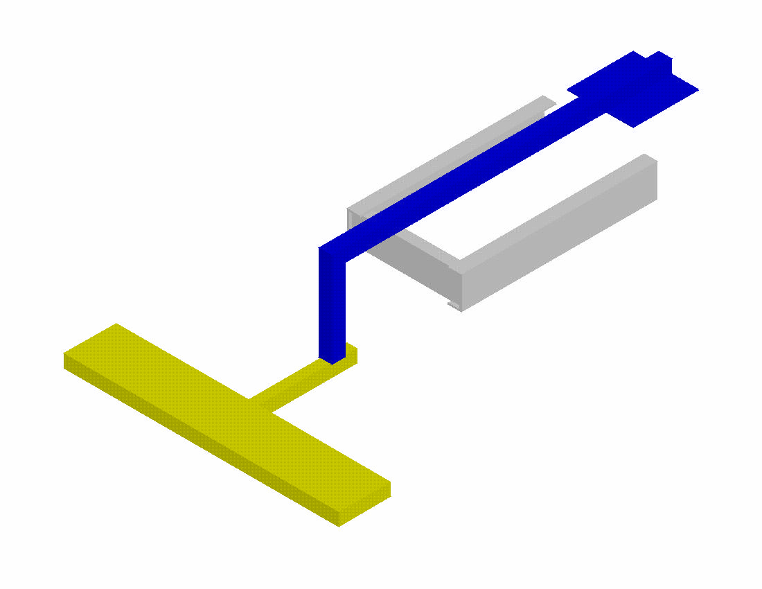

In chase vehicle configuration.
/ Need some design help #22
There are basically two desing approaches.
1. Make the trailer "convertable" so that it can be towed with a fifth wheel or a ball
2. Make a universal hitch to fit the tractor so that the trailer can be towed conventionally.
I think with my rotating tongue idea I am leaning towards option 1.
Comments?

I think I can get on the bandwagon for the 'convertible' dolly set up because it sounds like a more simple attachment when it comes time for the driver to hook the whole thing up to the truck. With that in mind, let me run an idea by you. What do you think about permanently affixing a slightly larger piece of square tube (like one of WHarv's reciever tubes) to the dolly tongue coming upmaybe half a foot at 90 degrees from it (like you show the upright part of the 5th wheel adapter) into which the tube with the 90 degree piece could be inserted?
My thinking there is that I have no reason not to have an upright there as it won't be in the way at all and that the rest of the fifth wheel adapter could be easily removed in two or more pieces. Again, the attaching pins could allow adjustments to the length as well.
My big concern (based on a lack of knowledge of what these tubes can and cannot withstand) is whether or not this tubing is going to be able to take the twisting and torquing I forsee in this application. I'd just hate to get a phone call telling me the chase vehicle and dolly took off on their own. /w3tcompact/icons/shocked.gif
The entire new fifth wheel tongue would probably run six feet from the fifth wheel to the drop, about two feet to the attachment point on the original dolly tongue and that runs about another six feet to the dolly axle. That just seems like a pretty good distance for tubing to run towing a car/truck on a dolly. Am I worried over nothing here?

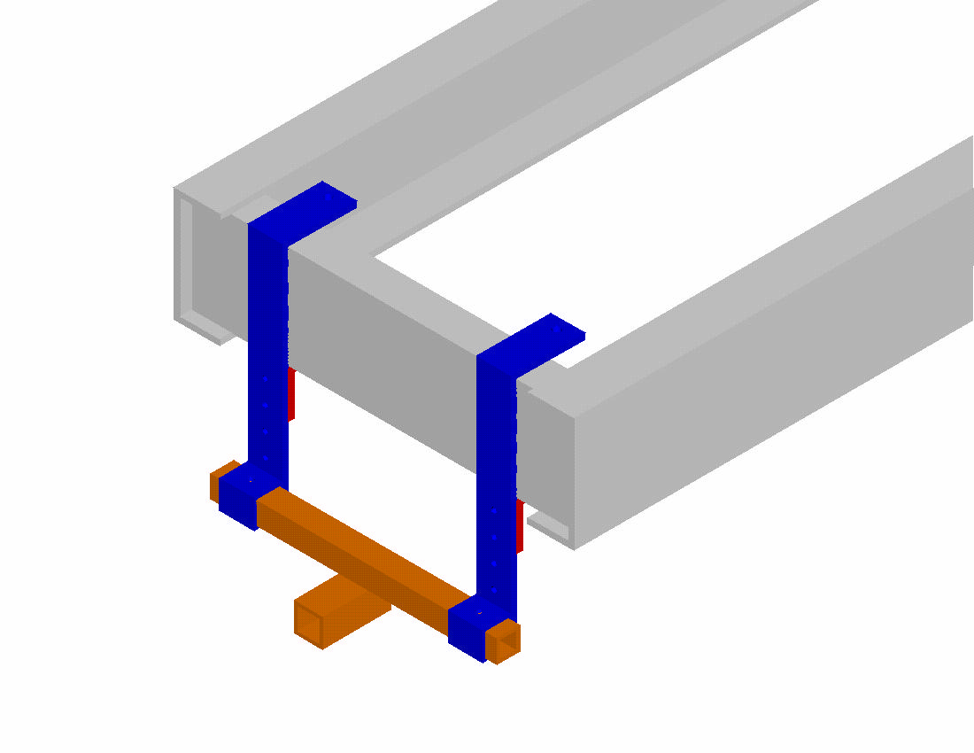

Harv, my very first thought on this was very similar to your U-bolt idea. I was going to use a single piece of 1/2"-5/8" plate slightly wider than the frame rails to accomodate two U-bolts on either rail. The length of the sides under the rails would be such as to accomodate one U-bolt at the rear on the angles section of the frame rail and another forward enough to be on the flat. The front side of the plate would be cut 90 degrees from the sides. The back, however, would come to a point so the plate took on the appearance of home plate. At the back point would go my trailer ball (or receiver). In the middle of the (home) plate would be a loop, hook or eye-bolt.
The driver could toss this on the ground, place a bar with an attached ratchet across the frame rails, run the ratchet strap to the center of the plate and crank it up. Then the U-bolts could be attached without having to hold and balance the plate. When that's done just unhook the ratchet strap and toss it and the pipe in the trunk, put the dolly on the ball, load your car and go.
Why didn't I go with this plan? Well, to get the U-bolts far enough forward to get the front U-bolts on the flat part of the frame rail moved it dangerously close to the tandem air bags and, even without that problem, I wasn't sure if the tension on the two U-bolts on the flat of the frame rails would be sufficient to keep the assembly from sliding back.
I know U-bolts are all that hold cargo boxes, etc., on straight trucks but also know they have the downforce of the box working for them, too.

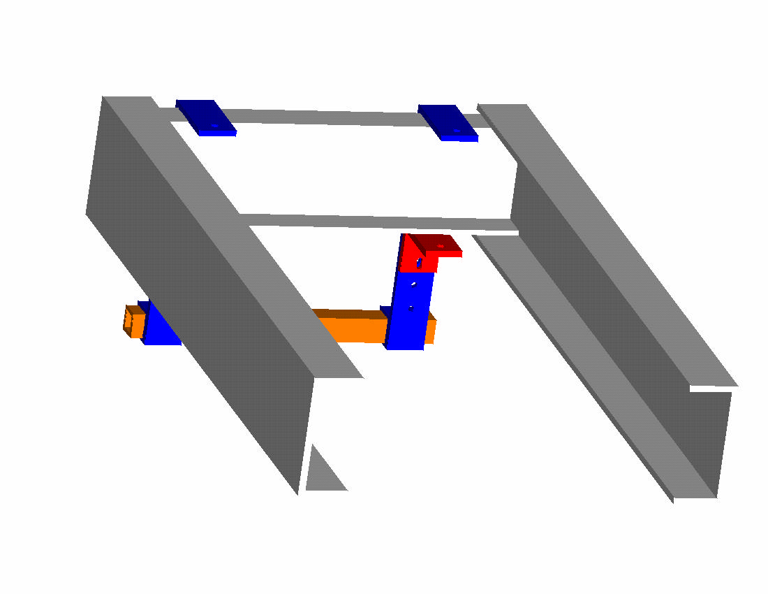

Gary,
If you go for the swinging tongue, you would only have to pull one pin, and then rotate the tongue. No need to assemble/disassemble the fifth wheel tongue.
If you go with a car trailer instead of the dolley, you can beef up the tongue as much as you see fit, IE build it more like a frame, than a single tube.

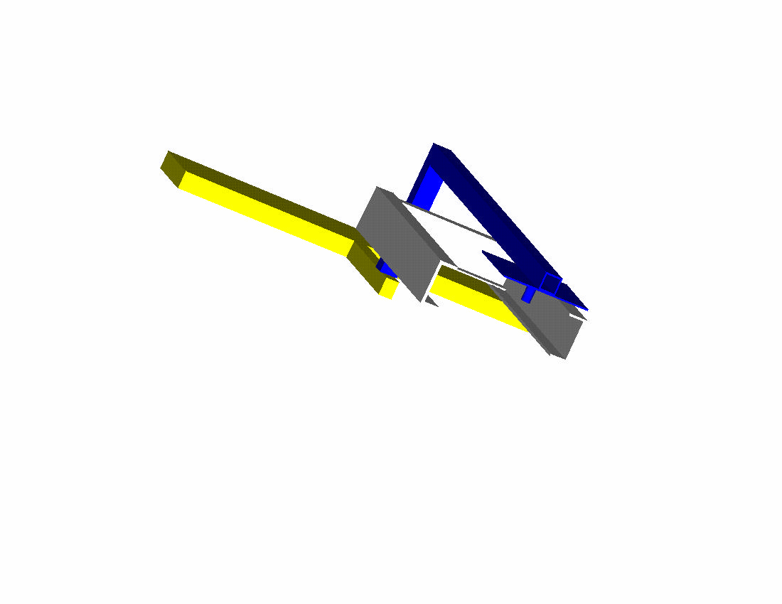

Here is the beginning of a the "framed tongue"
You could add diagonal bracing and additional members as needed.
I would put a flat plate on the bottom of the rotating post to give it a bearing surface you could grease to make the rotating easy.
I think the trailer would give you better "tongue weight" on the fifth wheel, I don't know how much it takes to keep the things together. You won't have to worry about overloading the big truck.

I definitely like the idea of the swinging (or at least reversable) fifth wheel tongue extension. I assume I should still be using tubing and not pipe for each of those pieces for strength, right?
The only other thing I'd want to add would be a similar connection in the horizontal piece so the length of it could be adjusted for varying distances between the fifth wheel and the rear of the frame rails and so that when the dolly isn't being used as a fifth wheel option the tongue extension could be removed in smaller, lighter sections.
Would it be reasonable to attach a tube sleeve atop the vertical piece (making it something between a 'T' and an 'inverted L') through which the horizontal piece could be moved then pinned?

Gary, since yer havin so much fun with the CAD program, here's option Q.1.2
Tubular member from 5th wheel to double channel (similar to meat rail hanger) across frame rails at tail end of truck. {may have to sit foreward to accomodate beavertail rails, so this cross member would slide on tube like Reese}.
Drop leg from tubular assembly to 18" ball height for dolly.
Cross member could be U bolted to frame rails.
Make in 3 pieces, and pin together so it could ride in chase car trunk, and easily assemble by driver.
Blue piece (5th-rear could be telescopic to accomodate different 5th locations) Red piece (teletoung assembly to ball dropleg, inserts into teletoung) Green piece Cross member with sleeve for teletoung)
