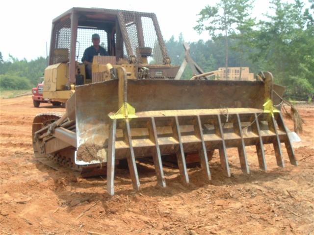

The rake will really come in handy for cleaning up your fields. I have one for my dozer and found that it really cuts down on how much dirt you get in your burn piles. Of course, you still get dirt, but not as much. One disadvantage of the rake is that you will find those hidden stumps with it every time!!!! Getting it on and off is also a challenge. Just be sure to take it off next to a tree where it will stay in position that you can hook it up again. I use my backhoe most of the time, but sometimes I've had to rely on how well I positioned it when I took it off. Be sure to chain it to the tree too. It will fall over if you don't. With the chain, I like to have it leaning away from the tree so that I can get in under it with the blade and pick it up. Once I have it resting on the top of my blade, I work on getting the pins in. Sometimes they go easy, sometimes I get to beat them in with the sledge hammer.
I don't know why you would want it adjustable. I raise or lower the blade to keep the tips just touching the ground. Mine extend a fair bit below the blade, which allows the dirt to pass through when pushing stuff to the burn pile.
Since buying my grapple, I haven't used my rake. It's allot better to pick up and carry debris to the burn pile if you have that option. Even with a rake, the dirt builds up on the burn pile and it doesn't take long to get several yards of it piled up. In my case, it was hundreds of yards when I built my lake!!!!
