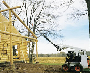

To add to what AKKAMAAN said, a cyl pushing straight on will have the highest force in lbs. If you angle the cyl, which you will do in a crane situation, you will have to compute the angle force. As far as cyl stroke and over all length of the cyl will depend on the geometry of the boom and mast and the height the boom will be expected to reach. You can make an extension for the boom by using a tube within a tube, and using a long cyl to extend and retract the smaller part. I would only extend about 2/3 of the boom and keep 1/3 inside the large boom tube. Consider wall thickness on the boom and maybe reinforce the outside of the boom.
