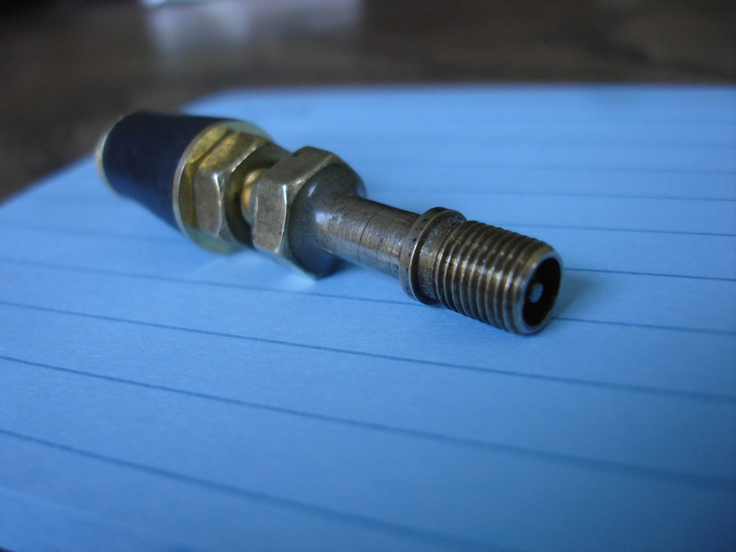

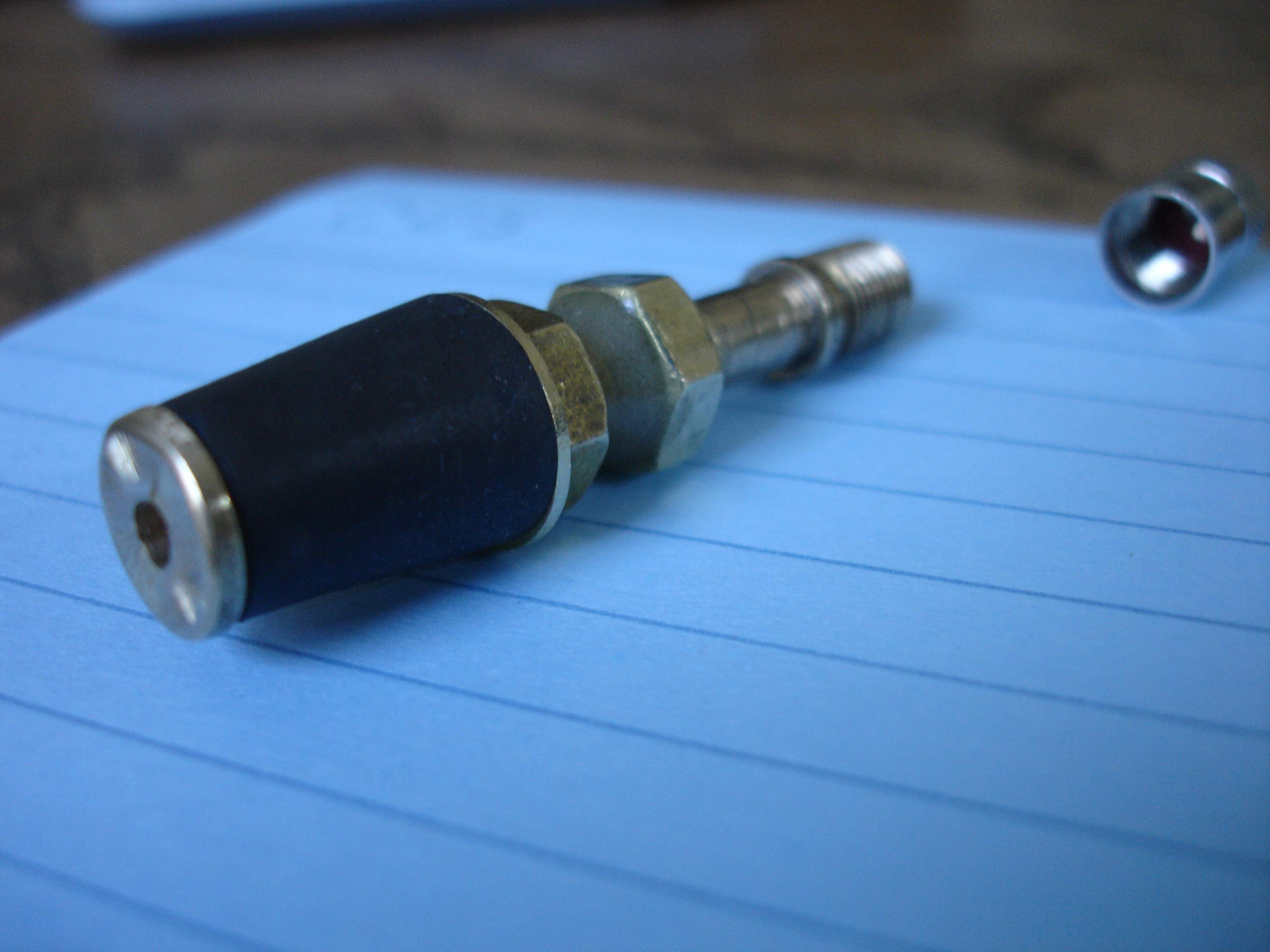

/ Need some help guys
#13
Soundguy,
Those stems had bugged me since the day I brought the tractor home - one of those things that always sticks in the back of your head - so I made the gadget attached to this post to keep in the tractor's tool box along with a Co2 filler and a tubeless repair kit.
Pat , I'm running 20psi rear and 25 in the front according to fact. specs. Have use the tractor a few times since last post and it is definately way less bouncy. A much smoother ride over bumpy ground. Used to feel like I was sitting on a beach ball.
