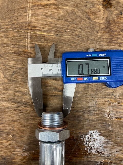

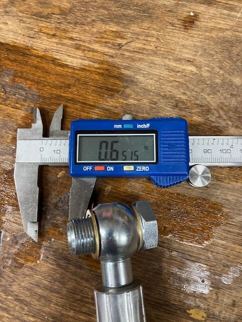

Finally had some time to work on my diy rear remotes and top cylinder for my box blade. I got the tractor end of everything installed and working! That was a fun learning experience. I've worked on all kinds of engines, but have only a little bit of hydraulic experience and most of that was swapping obviously broken components.
I need to either extend(about 12") or purchase longer hoses for the cylinder. I'm trying to determine what threaded fittings I have on my existing hoses. The banjo end doesn't really need to be a 90 degree for my setup.
Are those BSPP fittings?? Or am I totally off? I'll probably head into town tomorrow to see what the hydraulic shop has to say, but my curiosity can't wait till then!
From the amazon listing for the cylinder "Technical specifications: Connection: 12-L bulkhead size 3 (usual coupling connector), 18-1.5 SW22 nipple + union."
Thanks
Chris
