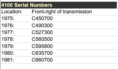

Better pics would help
Do any serial numbers resemble this

It looks like a 3550 (does it have wet brakes? If so, the rear axle housing will look like a trumpet...small at the wheel, large at the center case.)
Look at the RH ledge of the clutch bell housing for model code, date code and serial number.
The backhoe has its own ID tag if it is still intact. It will have one of the following numbers:
19-388 for a 750/10' backhoe
19-389 for a 753/13' backhoe
19-390 for a 755/15' backhoe
This 19-*** number tells you what size/model backhoe you have to get the right parts.
