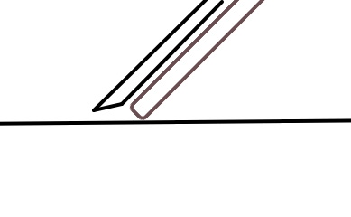

A few months ago I was looking at a new post hole auger in a store. The cutting edge was ABOVE the flighting it was bolted to. The mounting holes appeared round without adjustment.
I should have taken a photo but I keep forgetting I have a camera in my phone now. Here is a crude drawing.
