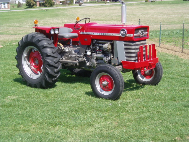

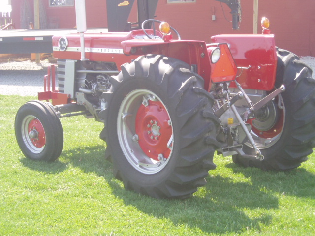

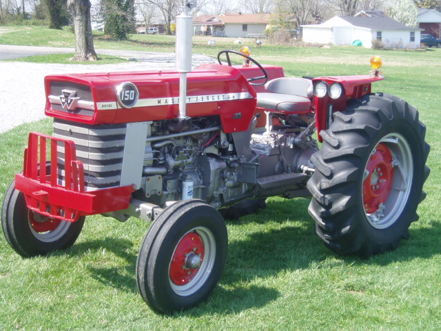

Find you one of these! This is my 150. It is, for the most part, a rowcrop version of the 135. This one is a diesel, 8-speed, and one owner....me. I bought it new in 1971. They haven't printed enough money to wrestle this thing away from me either.
Fuel efficient, quiet running, good power, well balanced, and as dependable as the sun coming up every morning. I'll go toe to toe with anyone that these were the best utility tractors ever built.
