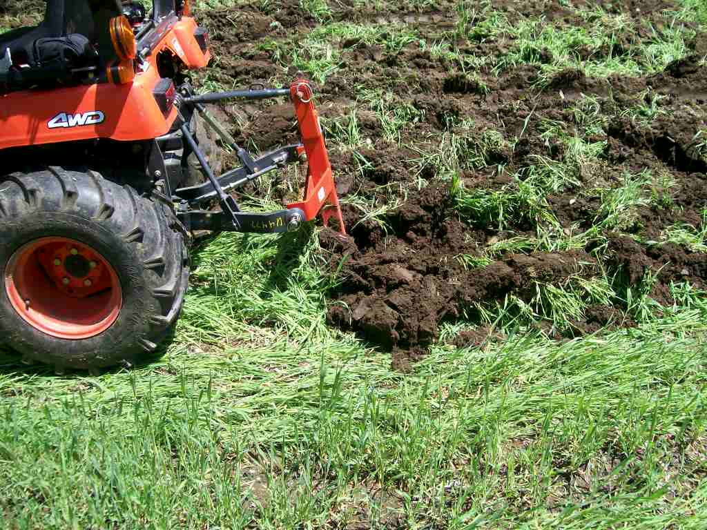

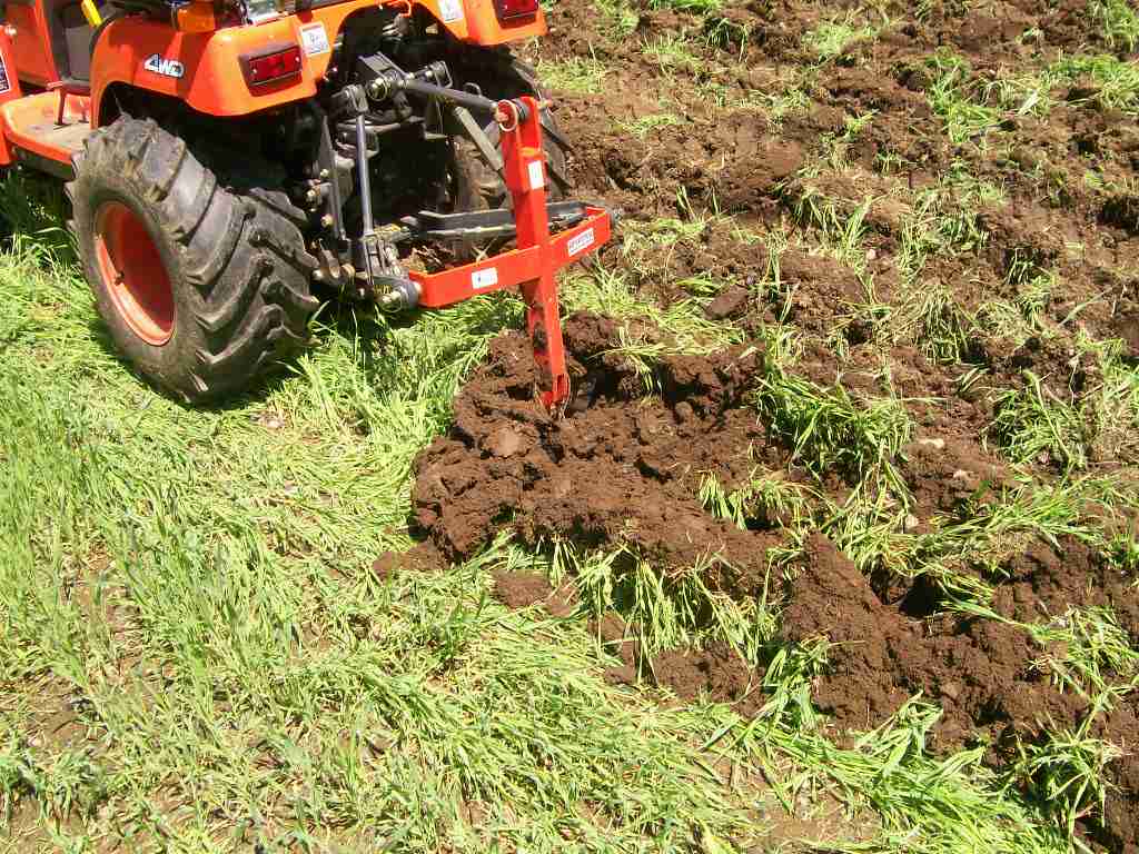

Perhaps these pictures of a middlebuster mounted to the 3pt hitch on my old BX will clarify the use of the top link. As you can see in the pictures, there is a piece that goes from the bracket you pointed to in the illustration to a rear mounted implement. It is adjustable for length so that you can change the angle of the implement relative to the ground. As others have mentioned, they come in standard lengths for a given hitch size ( you would use CAT 1) but can be had shorter ( might work better on your BX1800) or longer than standard. Hope this helps.... :)

got them and yes thanks helps and doesn't look so scary to figure out.

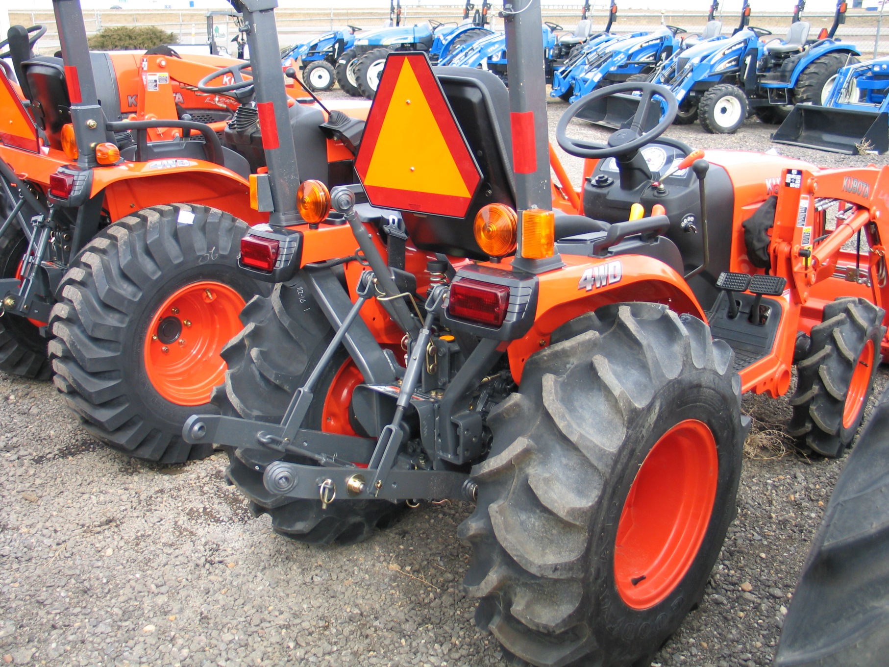

Here is a closer pic of how the top link mounts to the tractor..

No levers for a standard toplink.. it pins to the tractors toplink rocker and then pins to the implement..

I was reading the responses to this posting and wanted to make sure I wasn't misunderstanding your question. The lever immediately right of where you sit with the black handle does lift the 3-point hitch and I'm sure you already know that????? The top link really only balances what you have hooked to the lower support arms and doesn't actually do any lifting itself. It also adjusts for the implement you have, like a box scraper, to create a lesser or sharper angle as you pull the thing. The space with nothing there is also on your immediate right, but toward the rear of the tractor. I am assuming that we had this right in the first place???? John
