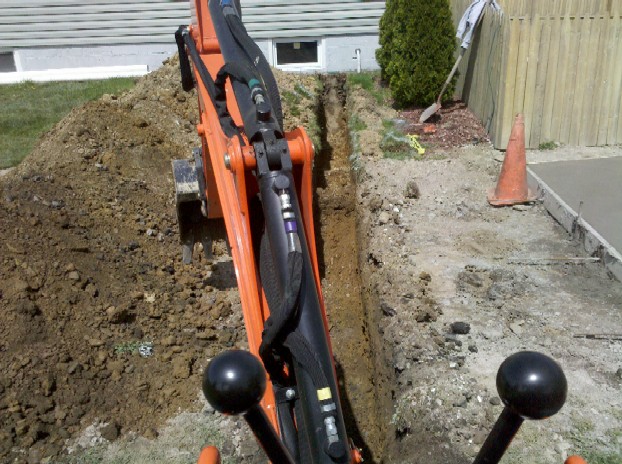

Thanks for the additional info guys. My email notification must have quit working...
It started out 1/4" in 4' pitch, but then it got a little steeper. Around 3/4 to 1" in 4'. I think I'll be OK. And I did use 2-45s to step it down when I came to the driveway. It finished 38" below grade, which should give me plenty of drop when it comes time to run it to the road where they'll be 8-1/2' deep. I was pretty happy with that depth considering the ground was falling away. I'll put my cleanout in at that time. Right now I just capped the pipe (not glued of course) and set a 4x4 post in front of it cut flush with the ground. That should give me a good surface to dig against when it comes time to find it and trench again.
The guy at the town hardware store said everyone runs 4" drain for sewer around here, the kind with the flared ends like drain tile. When the time comes for the line up to the road I'll double check what the township wants me to use, or if I can even do that part myself, but the line under my new driveway is done anyway :)
I just had time for one pic with my cell phone.
