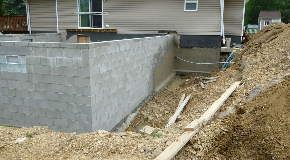

BuilderML, thanks for that explanation. Do you think either gravel or limestone should work?
The same stone you have in the picture looks like nice stuff. As far as limestone goes i am not familiar with it but gravel is fine. Alot of different names for the same product when your dealing with different locations. As far as using plastic, did you think about doing a layer of rigid foam on top of your stone before pouring your slab? Just tape your seams. 1" would make a big difference. Also run it up the walls so that it is above the finish height of your slab. You would basicly be pouring your slab on a bed of foam.

I think I figured out the problem. I started digging a trench by the area that was getting wet. I found a 6" terracotta pipe in the ground that just ended by the edge of my porch which is about 12' from the area of the basement that was getting wet. The pipe was wet inside. I kept digging away from the house to follow the pipe, pulling the sections of pipe out as I go. I dug back away from the house about 20' and had to stop because my sidewalk is there. If I look in the pipe with a flashlight, you can see about 20' back. I left the hole I dug open around the pipe to watch it. It rained on Saturday and you could see a good amount of water running from the pipe. I put a sump pump in to pump the water out. I'm pretty sure this could be causing my basement problem. I have no idea where the other end of the pipe goes. I looked everywhere. The direction it is heading is towards the back of my property. I have 2 acres, so it could go anywhere. I don't really have a way of running the pipe to the road since it is below anything that I can have it naturally drain to. I think I may just plug it. The guy that owned this property before me had drains everywhere. Allot of them I pulled out already. Would there be a way to find out where the drain would go to? A snake wouldn't work since the other end could go anywhere.

I thought about putting a expandable rubble plug in the pipe then cementing it. The other end is obviously not being used for anything relevant of what I can tell. My property goes back pretty far, so the end could be anywhere for all I know. I can't visually see the other end of the pipe. Even if it leaks very slowly in the excavated area, I would hope the water would dissipate into the ground before it can reach the basement now. The trench that comes from the house to the hole is about 20' long and I back filled the trench with clay dirt.The hole I have is about 5' x 5' and about 4' deep. The end of the pipe is 3' deep. If I plug the pipe, dig the hole a little larger then fill it with aggregate, that may work.
