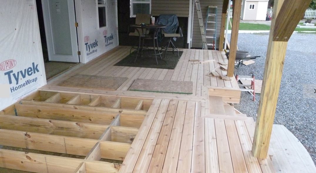

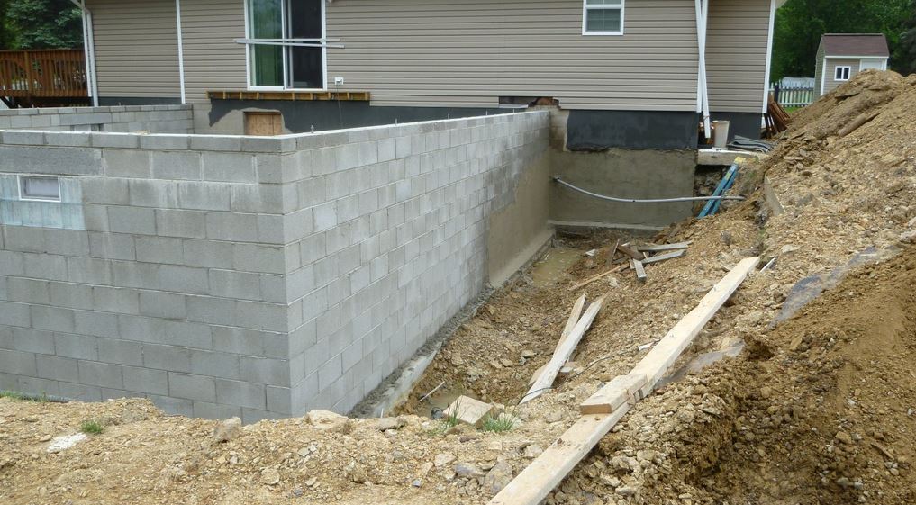

If you look at the picture with only the blocks up, you can see where I parged the wall and also put parging between the bottom blocks and the footerr so that water flows away from the footer. That is the part of the addition where the water is coming in. I did parge all of the foundation that is below grade like that and put 2 coats of foundation coating on it. I then wrap the under grade foundation with Grace TriFlex. If you look at the picture of the deck that is now there, you can see that the deck extends out from the foundation a little over 12' and the gravel drveway slopes away from the house. The spot of the foundation that you see in the first picture is under the deck below the table and chairs in that corner.
Also, I put dirt up around the foundation under the deck to slope away from the house. I will take some pictures of the inside of the basement when I get home.

Is that a pipe or conduit in the first pic, maybe water is folowing it to the foundation. Were does the other end go?
There is water in the corner of the first pic, from rain or ground water? Water will flow the path of least resistance.

Hard to tell from your first two pics, but it seems maybe the parge and triflex are not enough, or there is something about the water table in the area in question that allows water to seep there over time after heavy rains. I was wondering if you could allow the drywell to let water pass through it to daylight long enough to see if it is causing your issues? By this I mean for you to essentially bypass the drywell with a connected non-perforated pipe to see what happens during and after a big storm. Are your roof gutters doing their job and what are they connected to? Drywell? Run to daylight?
It also doesn't seem you have very much pitch away from the house/foundation, but with just one pic it's hard to tell.
