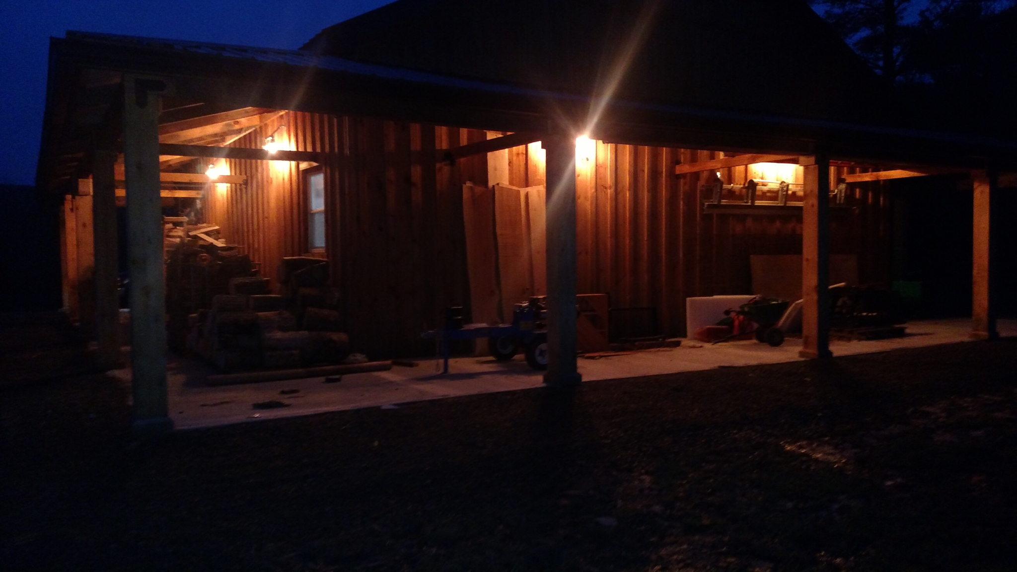

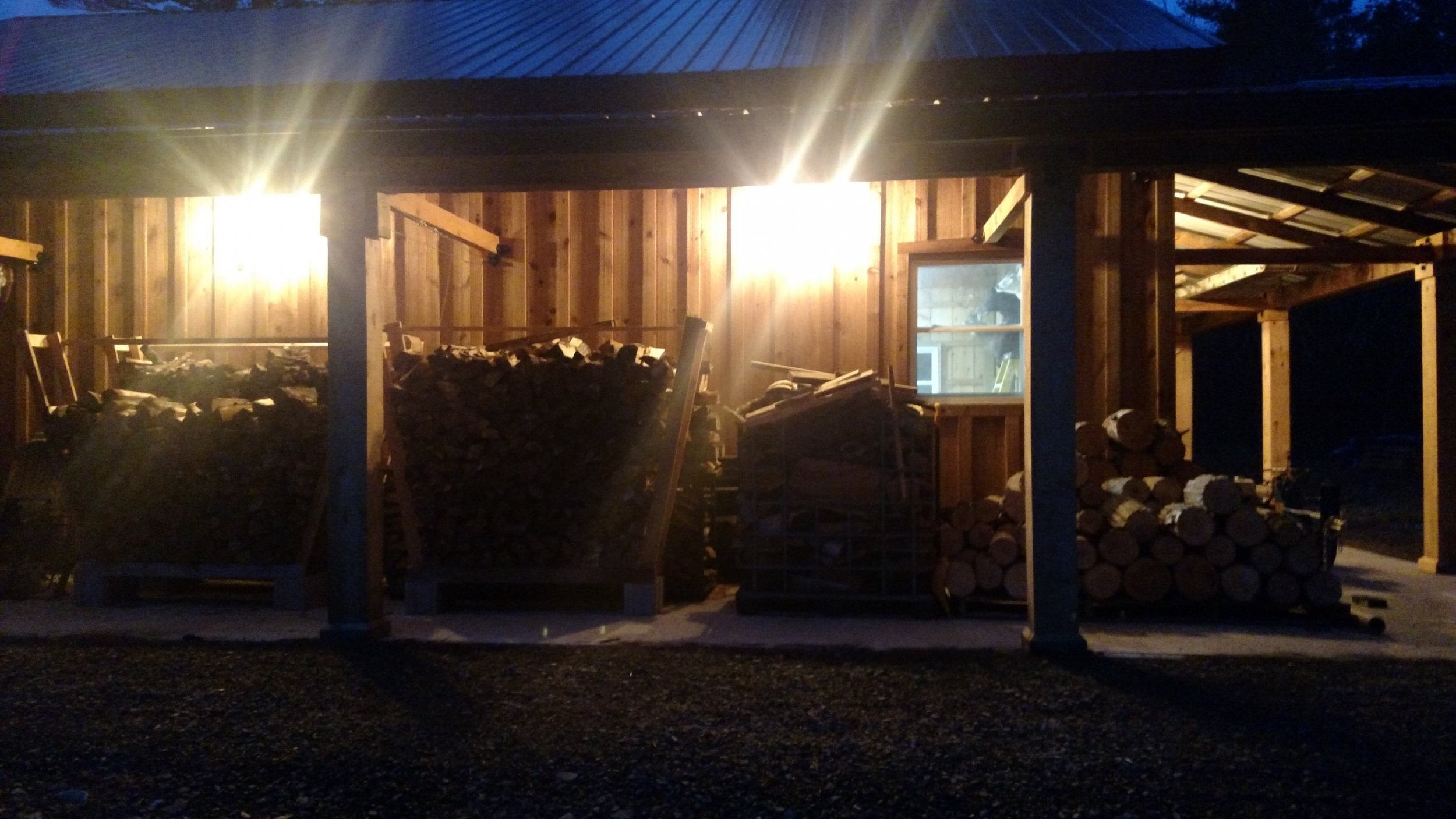

I made the outside lights out of black pipe. Couldn’t find anything I liked that was at a reasonable price. Needed 10 lights for the outside. Decent ones were $200 a piece. Made ones for $50 a piece. Don’t have a good pic of them up close.
