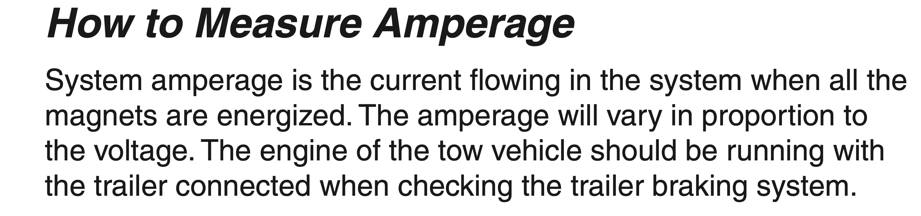

As voltage increases, so will amperage. My MaxBrake controller display shows the amperage and voltage being delivered/used by the magnets in the brakes. As I apply more pressure on the brake pedal, the controller delivers more voltage and amperage. Amperage is what does the work. I tried to link a Dexter Axle article, but their web site is having problems. Here is one that explains how to troubleshoot brakes. It clearly states, "System amperage is the current flowing in the system when all the magnets are energized. The amperage will vary in proportion to the voltage."
TROUBLESHOOT ELECTRIC TRAILER BRAKES

No, as I said ohms law is a fundamental law of nature. Current (amps) equals voltage devided by resistance. Increase voltage & current goes up. Increase resistance (bad wiring or bad magnets usually) & current goes down when the voltage stays the same.
You can either regulate voltage or current, but not both. The other one varies according to the resistance of the circuit & ohms law. Brake controllers along with most electronics regulate voltage.
   / Need stronger brakes, what can I do? #90
I know what the display on my MaxBrake controller tells me. I know what my multi-tester will show when checking individual brakes, and I know what Dexter Axle shows on page 21 of their troubleshooting guide:
Screen Shot 2020-01-17 at 4.26.12 PM.png https://www.dexteraxle.com/docs/default-source/default-document-library/medium-duty-electric-brakes.pdf?sfvrsn=0
All done here. :)
