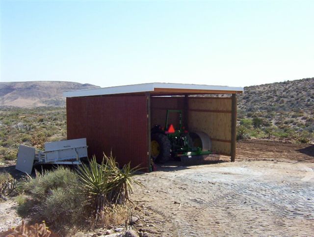

I just built a nice little carpor/tractorport for my new JD 990.
I made it 20' x 15' but you could easily modify it too make it larger. Here is the site I got the idea from. http://www.buildeazy.com/carport_imp.html
I too was on a budget and kept the final price with delivery and all lumber down to about 1,500.00 I used 7 4x6 posts, 2x6 rafters 24" on center and 2x10"s for the side and front and back beams. I sheeted it with OSB and then installed a metal corrigated roof over 30 pound paper.
Good luck
Derik
