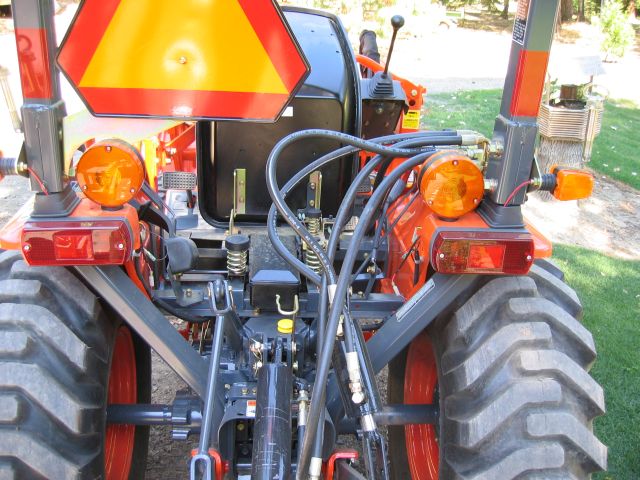

On my B2150HST, I installed a plastic milk crate on a wooden platform that I'd assembled between the ROPS verticals, using 2x6" lumber and large u-bolts. I use it to carry up to four 15' choke chains, 30" loppers, snatchblocks, first aid kit, fire extinguisher, and Gatorade, plus whatever else I'll need out in the woods.
I need to do the same on my B7800, but there are obstructions in the way: primarily lights, the foldable ROPS, and the hydraulic hoses for the top 'n tilt system.
I've attached a photo of the B7800 area behind the seat where I'd like to put the carrier. And I'd like to ask if anyone can offer any ideas or suggestions on how I might get this done.

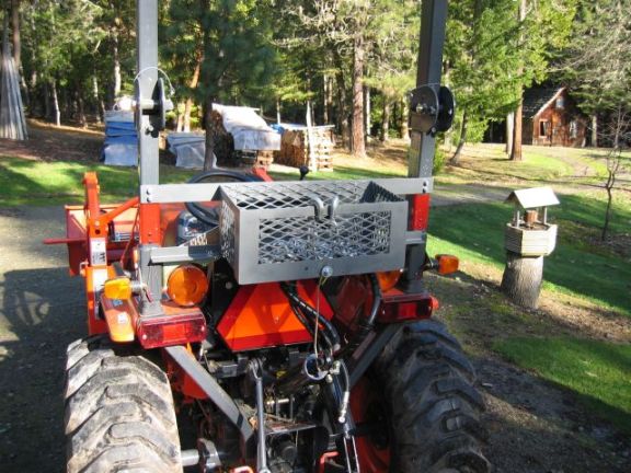

Well, it's been awhile since I originally requested help, but here's what I finally ended up with (photo attached). I had a fabricator make a box for me, and I installed it on the FOPS. I then had to move the SMV emblem to the back of the seat, using stand-off bolts to keep it as vertical as possible, so as to reflect the greatest amount of light.
This set-up represents a lot of cut-and-fit work and a lot of compromises in size, location, etc., so is not at all perfect. If I had to do it again, I'd do a few things differently. Live and learn. However, it does a satisfactory job of carrying most of the items I need when I'm out in the woods on a job. It does not interfere with putting the FOPS in either the folded or extended position. Note also that the pierced metal allows the operator to see what's happening with the 3PH and drawbar.
While some may be put off by my attaching it to the FOPS, Kubota left me no other options. I need that box. And when I weighed the priorities of attaching it to the FOPS or having no box at all, the FOPS lost out. Based on experience, I expect that I'll get more than enough benefit from having the box where it is, with no weakening of the FOPS structure itself due to the several 5/16" holes drilled in it.

Neet looking box, Norm. It does have the potential of reviving Henro's now classic "I drilled my ROPS" thread. /forums/images/graemlins/grin.gif
Any reason why the box couldn't be attached to the ROPS verticals with U-Bolts? /forums/images/graemlins/tongue.gif Seriously, I don't really think that the bolts will adversely affect the integrity of the ROPS at all.
