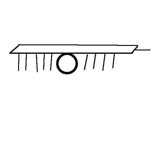

I want to create some kind of grass de-thatcher to use on my L3410. I would like to build somthing in the 72" range. It seems all I can find is the small pull behind garden tractor models.
Any suggestions? Has anyone constructed somthing large to de-thatch? Any Pics?

You could take a sheet of 3/4 inch plywood, cut it to desired dimentions, put an axle and tongue on, and mount spring teeth from a hay rake on it. Most expensive part would be the axle and tongue.
Very crude drawing attached.

Spring teeth from a hay rake (you can buy new ones from places like TSC) will fit over a piece of pipe. Use 1/4 or 5/16 bolts with fender washers to hold them in place. The pipe can then be bolted to a frame (bolt, don't weld so that you can replace broken teeth). If gang up several of these pipes on a frame it should do a good job of de-thatching. I'm currently making a "dump" rake for my Yanmar 1500D to to clean up leaves and branches. I brought a bunch of old dump rake teeth and I am mounting them to a cross piece will will attach to the 3pt hitch.
For de-thatching I purchased a chain drag. YOu can fine adds for these in Western Horseman. They spread droppings and breakup thatch will well. This is recommend as routine pasture maintainence.
