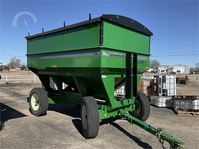

My first choice if it was feasible would be a gravity box on a wagon.
This is the first one that comes up on Auction time and it's even in Texas; 325 bushel / 13 ton capacity
https://www.auctiontime.com/listing...Be6aE49EGR40TlWcaAMD1YFM7c4ihuzBoCAdwQAvD_BwE
