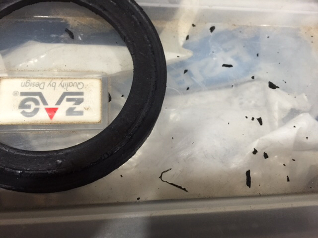

You'd think that. But New Holland was still selling fuel caps that don't tolerate biodiesel less than two years ago. It may "look like rubber" but you have to be more sure or you will be either replacing it, or dealing with pulling bits of "rubber" from your tank.
   / Need TC-40 DA fuel cap gasket dimensions #10
Bits from New holland fuel cap seal that can't deal with modern commercial diesel fuel.
