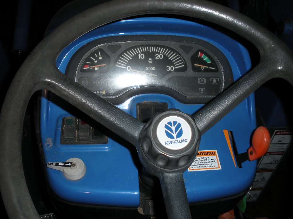

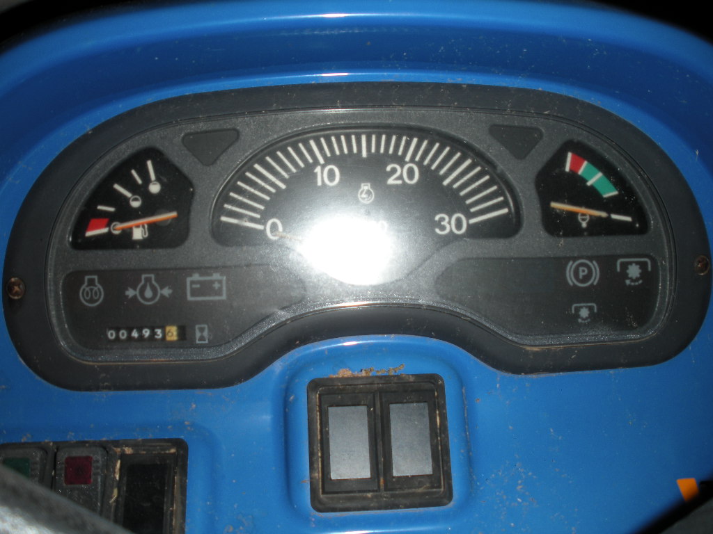

My dash :D
I got the serial number and the Unit number. Any idea what the unit number means? Will make some calls/emails tomorrow.

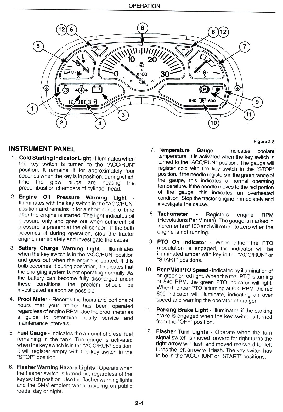

No matter what the manual says, your dash is just like mine; I checked photos I have of my dash. In my last post I mentioned that the PTO ON light was on the left, but it is obviously on the right (the larger light to the right of the parking brake light) and the small one is for a mid-PTO, I believe. The 540 and 600 lights are directly to the left of the mid-PTO light. If you squint, you can just make them out on the panel even without being lighted. It's too bad we don't have a "press-to-test" button to light up all the lamps in the dash panel.
EDIT: Scan of my Op Man'l page for the dash. My manual is dated 1999.
Oh yes...unit#0B13D = Manufactured on Feb. 13, 2000 on the Day shift.
