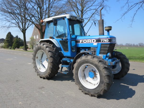

I don't know if they came with a narrower 38" tire but my guess is that they did not.
Yes they did nearly all british ones had 16.9x38 and if I remember correctly 13.6x28 They do drive much better on this set up , faster , more grip and ride smoother and look far more fitting on the tractor

D7E...I could see a 16.9 x 38 and that would work. I would say that an 18.4 x 38, however would be more than the tractor could make efficient use of and would be more typical of the setup I have seen on the 9000 series Fords. That was the standard rear tire for them. The 16.9x 38 would likely be more of a row crop option because they would fit better through 30" rows of corn or other crop. In a row crop setup traction and lugging power is not so much the desire as is the ability to fit through a crop. There are probably a lot of tire options that were used on the 7710. I fact, the rolling circumference of the 18.4-34 and 16.9-38 are only an inch apart.
