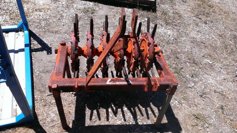

I too couldn't justify the $'s their asking to buy ......
So chalked this idea up & I fabricated this 3PL 40" corer/aerator out of our farm scrap about 5years ago - between me & my friends regularly borrowing it, it's done a lot more work than ever planned behind my Iseki TX2150's & Kubota B7100's without drama.
Each spindle/wheel rotates independently (they're cast press wheels salvaged off an ancient seeder which combined with the over engineered heavy frame saves the hassle of securing extra weights) with the "hubs" fitted with wheel bearings/grease zerks so they spin freely around the centre axle - not shown are the pin adjustable trailing depth wheels (I transfer them as required between implements) which slot into the rear square section where the stand legs are now.

Looks real good imo, if you have something like those press wheels to start with.
