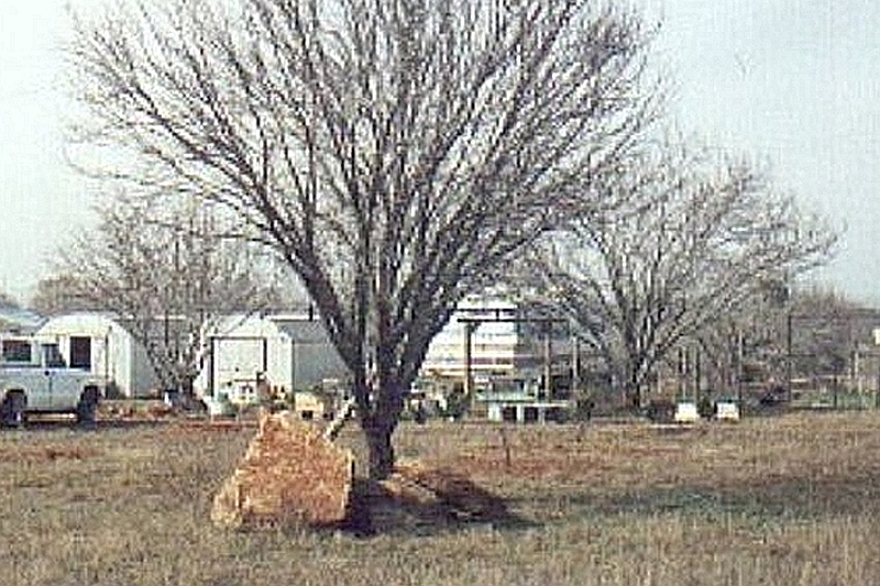

They grow in middle Tennessee. Every year is a new crop.
Yeah, they grow like tatters down here. There's a fresh crop every year. Even had to get the dozer out in the field a few times to move some in the 2-3,000 pound range. I can't imagine how those things float to the top. I have those saved under a tree for use in later landscaping, maybe. Those rascals can be hard on equipment. You can't push rocks back into the ground--They just pop right back up like corks along with new ones.
When you have 'em, you gotta pick 'em. Use whatever tools you have or can get that works in your soil. Except for the big ones, a tiller and rake works down here. Then scoop them up with a loader.
I've added to the pile since this picture was taken.
