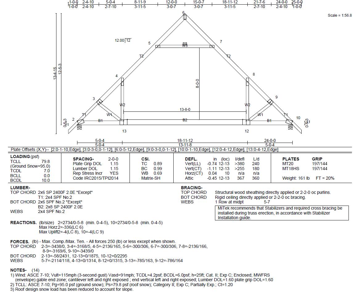

Yeah, the truss weighs in at 161 lbs.
If it spans 24 feet, and the pitch is a 45 degree angle (12/12), then the peak of the truss will be 12 feet above the top wall plate. With 10 foot walls, that puts the peak up at 22 feet.
My 4600 tractor with the 460 loader reaches 9.3 feet high at the bucket pivot according to the JD specs. So I would need a boom of about 16 feet beyond the pivot to be able to lift the truss from its peak. But (I think) the trusses are designed to be lifted from the collar tie at points 5 and 7 seen on the drawing. That's about 8 1/2 feet from the top of the wall. So maybe the truss could be lifted by a beam that grabs those two points from the bottom edge. If the cutting edge of the bucket extends 2 feet (swag) beyond the pivot, then an 8 foot boom extending from the bucket should be sufficient. I have hooks welded to the top edges of the bucket, so chains could be run from there to the end of the boom. Cool. This might just work.

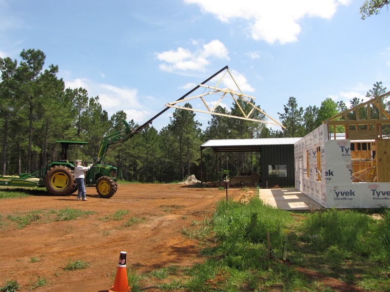

The tractor is a 5055E with the pallet forks and a 20' "H" beam. I had to reach from the side of the building over an 8' porch to the center of a 24' wide building. The trusses were just under 200#.
Caution: The further out you go, the more dangerous it gets for 2 reasons. 1) The torque (lever arm) increases rapidly and you'd be surprised at how little weight it can lift at 20' even if it can lift 3000# at the forks. 2) Tiny movements are greatly amplified at the end of that beam. A 1 inch movement at the pins of the forks results in a 2 foot movement at the end of the beam.

So, I'm thinking about what to add onto my 4600 tractor to serve as a small crane. It has a 460 front loader and the backhoe on the other end. I have pallet forks, so I'm thinking of slipping some square tubing over the fork tines to get a little more reach. Maybe join the tubes at the end and also add some hooks out there.
If you plan to fab something for lifting higher, have you considered fabbing something for the backhoe rather than the loader? Your BH's loader and arm will be more rigid than whatever you extend the loader with. And you'll have east/west truss tweaking.
The backhoe boom is almost certainly a better crane but the problem you’re likely to encounter is you can’t transport much weight with the stabilizers up without tipping backwards.
