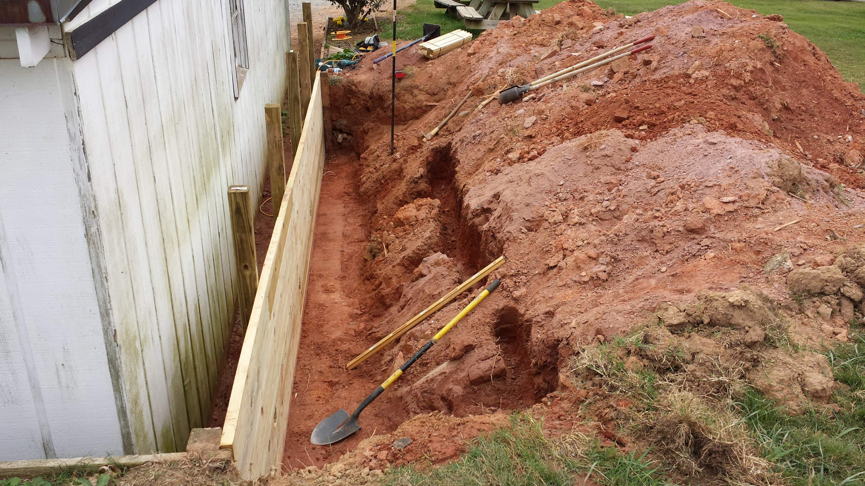

I dug out the deadmen with the post hole digger and a Collins axe
Deadmen.. Pressure treated 4X4 with 3/8 galvanized bolts.
Detail of deadman and post.

I forgot one.. This is the french drain. It's wrapped in a sock and I dumped about 20 bags of drainage rock on top of it and wrapped it in the landscape cloth. It's situated 2 inches from the wall and staked on both sides to keep the rock from spilling from the top of the drain.
I topped this completely with a shovel and compacted it with a tamper before pulling the stakes. I did the same with the deadmen and tamped them to the point of exhaustion with the back end of the Collins axe.
Then pushed the rest of the dirt with the Kioti.
I'll spread some winter rye later today and trim the posts to complete.
If anyone has criticism lets hear it so the next guy that reads this can look at all options.

   / Need to fix a retaining wall #15
I have no experience in retaining walls, but I would think your "deadmen" would have been more effective higher up. This would better help counteract the leverage the soil will have pushing on the wall.

#18
I was thinking that there would not be enough weight on them if they were higher but perhaps they could have been buried just as deep but with the connecting arm at an upward angle, higher on the post?
I'm unsure but what little research I did showed them level and roughly at the depth I have them.
My hope is that someone that does this for a living can clear this up for the next guy that gives this a go.
   / Need to fix a retaining wall #19
Gearhead is right and your thought of angling down from the upper part to the back side of the deadman is correct too...
