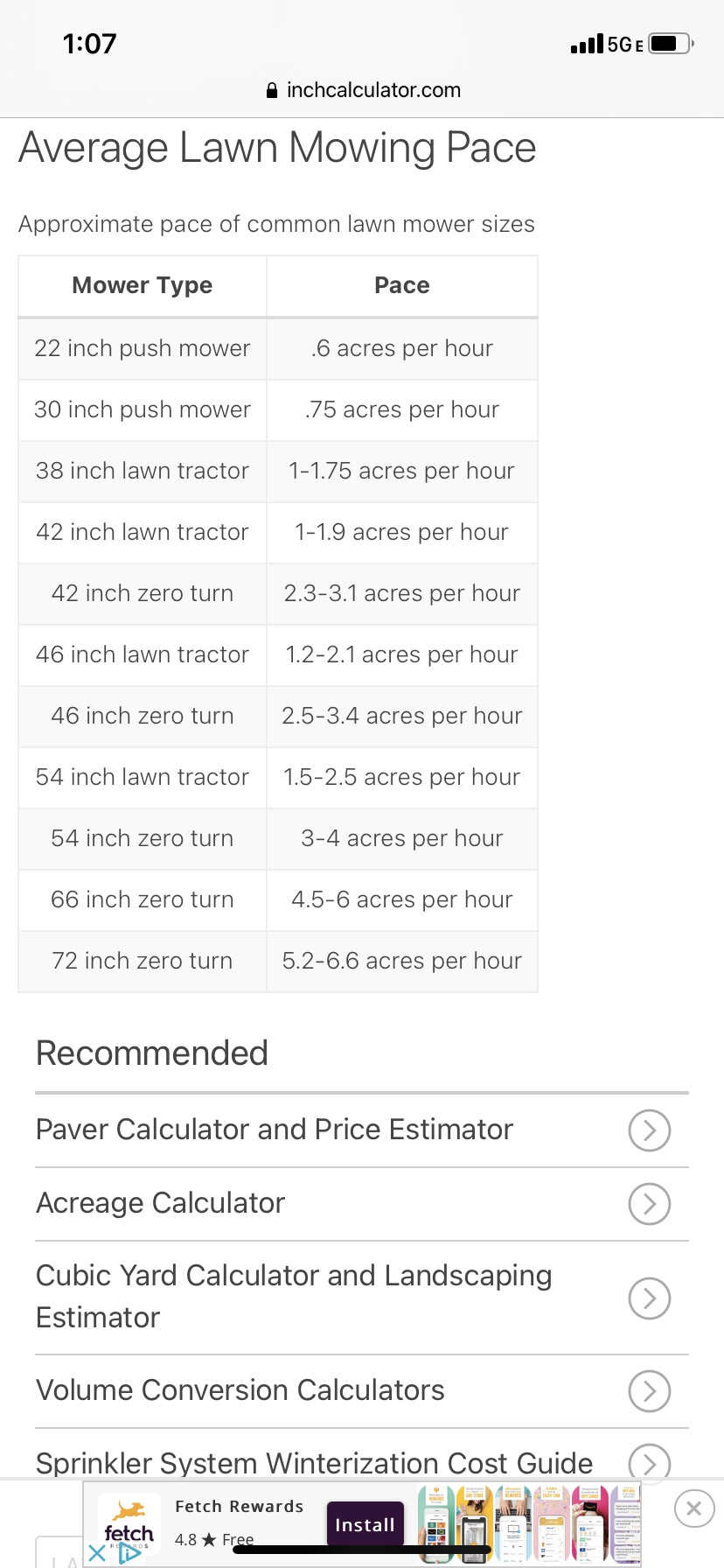

This shows, for speed of mowing, you cannot beat a zero turn.
