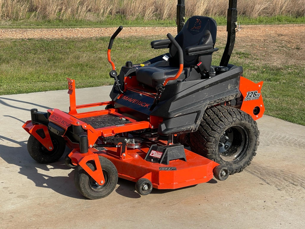

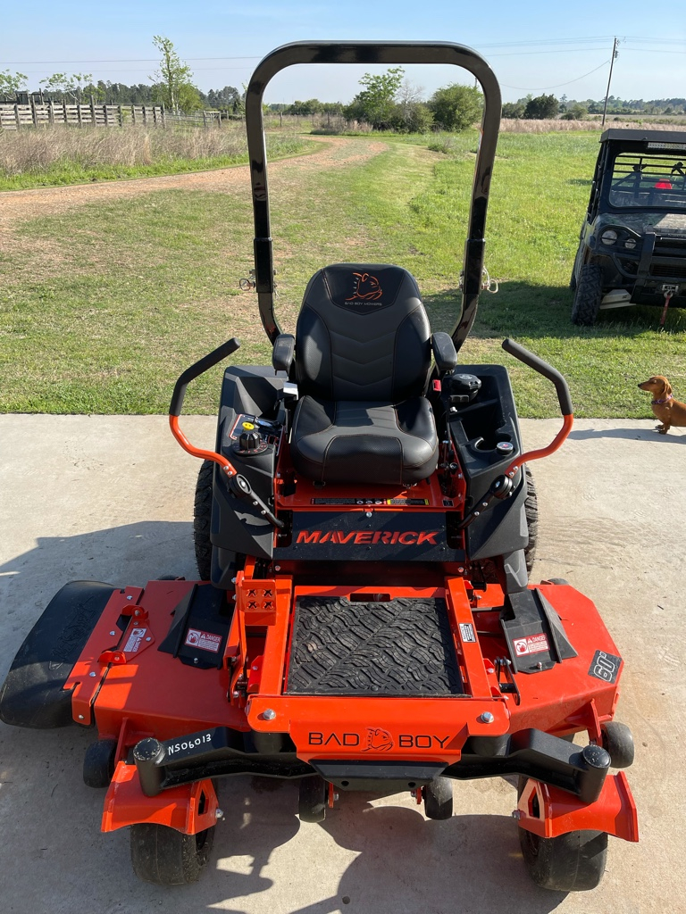

Great read - I just picked up a 2021 Bad Boy Maverick. Top residential / bottom commercial. Must say it has all the pluses I was looking for - easy access to all items, lift up foot plate, dial height, large tires, heavy duty deck and front casters, independent suspension all around, easy Maintenace, Kawasaki Engine etc.
Mowed for over 2 hours all around my property - mostly fence lines. Wow this mower is great. Handled all the thick and rough stuff with ease.
Won’t be mowing fields until my Wildflowers mostly die off in about 4-6 weeks.
This mower can scoot at 9mph when it is smooth. Cut is level and smooth, even in the few dewberry patches I took out with it.
YouTube has a few good videos on the 2021 Maverick. I almost got the ZT Elite and glad I did not due to all the rough terrain I have.
Questions let me know.
Price point - don’t think you can get better.

@frogracer It looks like yours is a 60". What HP engine does it have? Also, if you don't mind, can you give me a ballpark figure on price?
Edit: Never mind on the price. Great price but way out of my budget for now.
