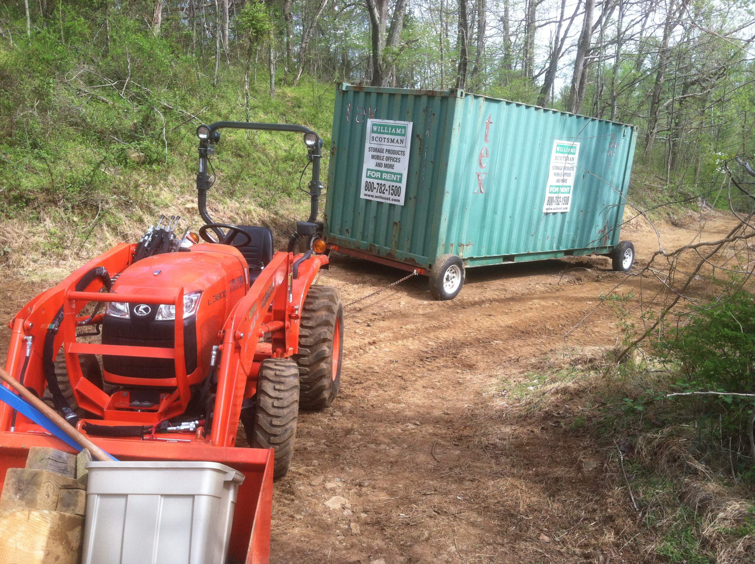

IMG_1115 low rez.jpgI'm goning to hijack here
Here's what I moved last week about a half mile up the mountain.
8 x 20 5000 lb shipping container.
I made some axles out of salvaged 3.5 x 3.5 steel tubing and some axle hubs that I bought from Northern Tool.
Bolted the axles to the shipping container.
I just pulled with the tractor on the mostly flat up hill portions.
For the long 20 plus degree uphill I was chicken to just pull with the tractor alone.
I used about 700' of 3/8" aircraft cable that I had laying around, put a snatch block on a 4' diameter poplar tree at the top of the hill. hooked one end of the cable to the shipping container and one end to the tractor running back down hill and pulled it up will relative ease. I had to chock the rolling load a couple of time to choke up on the cable and/or winch the container over to one side or the other to steer.
   / Need to move a building #20
Keep your tow chain short and everything low.
