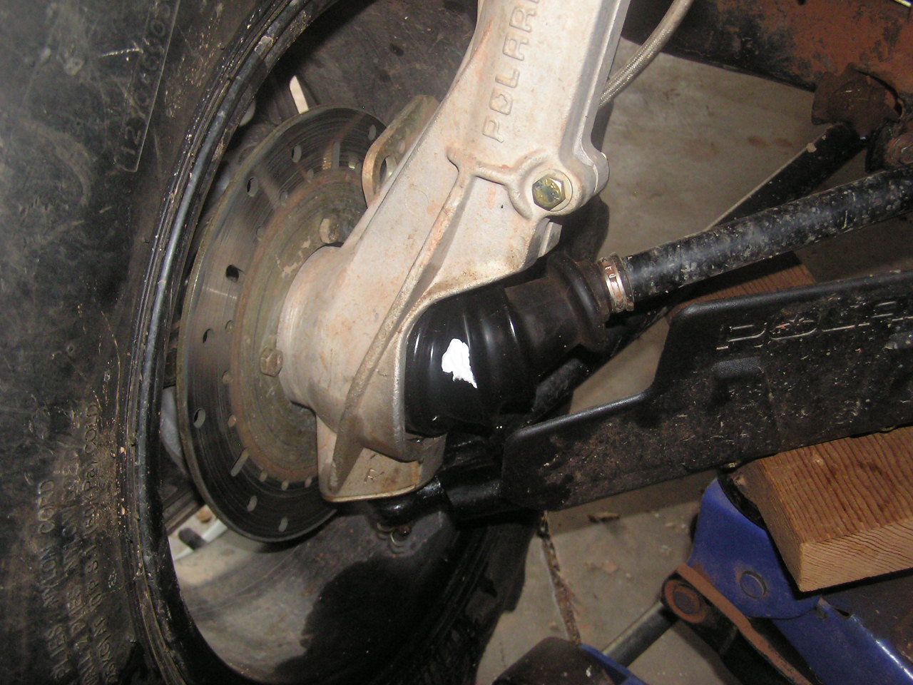

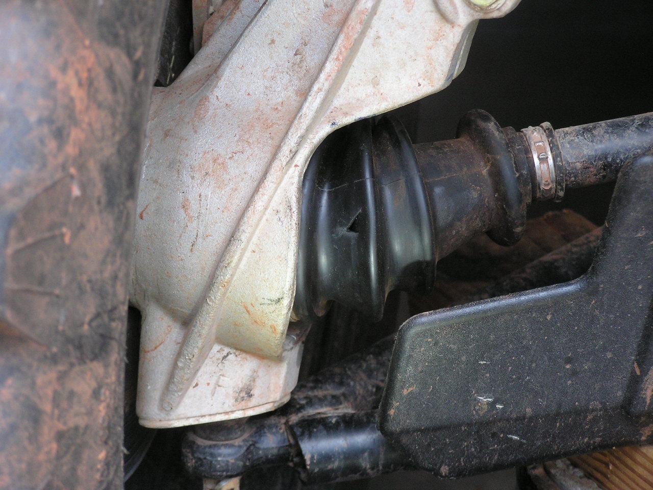

Yep, I used the 5200 White to seal a punctured rubber CV boot 6 months ago and it sealed it good.
