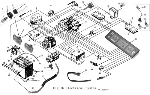

Be careful. I'm thinkin' Chris has the better solution. My TS354C has the same wiring harness as your TS254, and there's no way I'd even consider trying to fit a Jinma 200 series harness on mine. As you possibly already realize, the TS254 is physically a larger tractor than the Jinma 200 series. Yes, in some cases the engine is the same. But besides the fuse panel being in a totally different location - and the cluster connector being possibly incompatible - the Jinma harness would almost certainly be too short to reach many of the required TaiShan connections.
That said, a Jinma 300 series harness might be long enough, but but there are still the matters of fuse panel location and connector compatibility. If you want a better picture of what you'd get into, I recommend you compare your wiring diagram with that of a Jinma 300 series. I'm not sure if this diagram is of a 200 series or a 300 series, but it might help decide whether or not to try a wiring harness from a completely different tractor.
