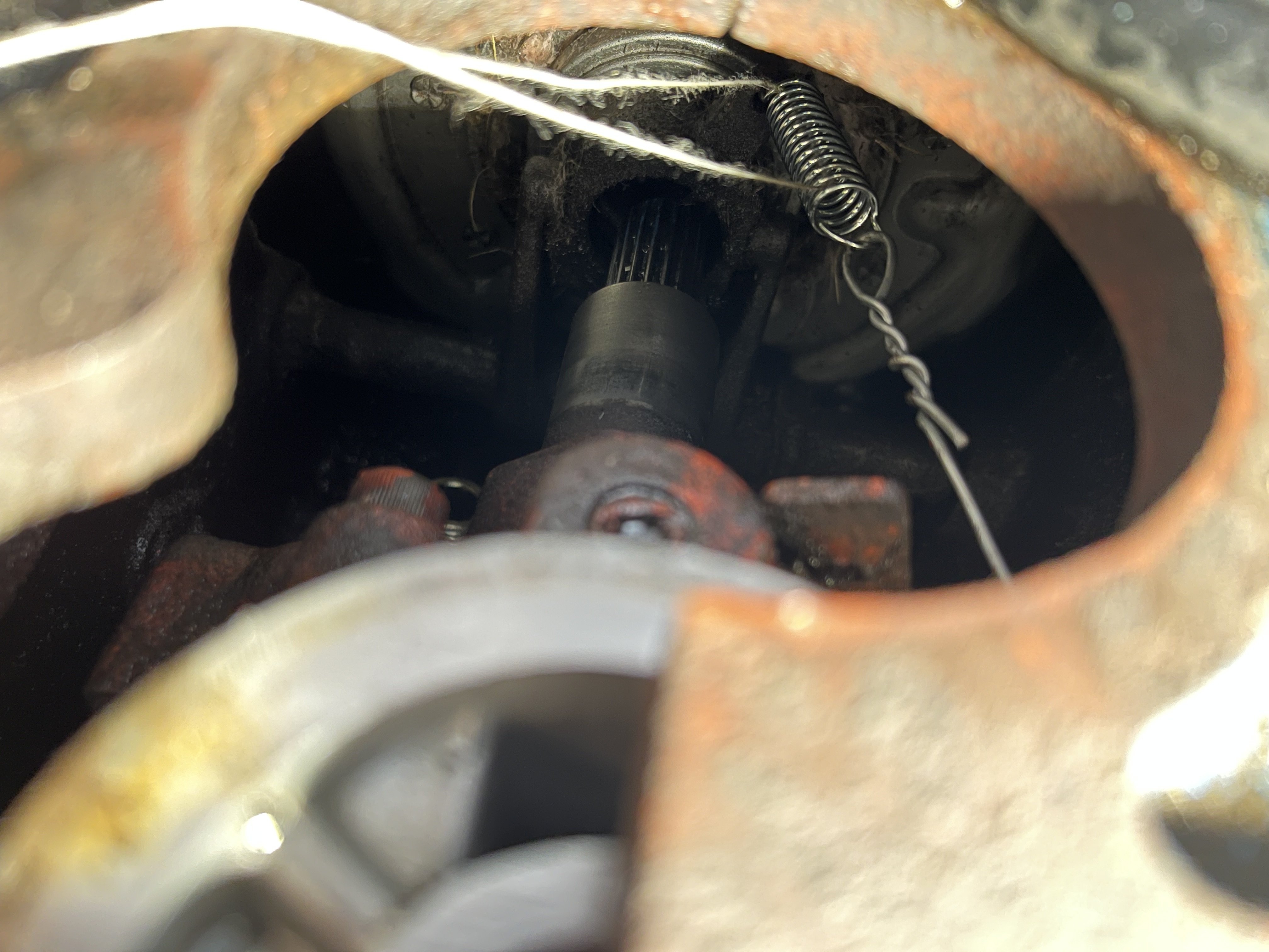

I have had the fwd/rev control rod detach inside the transmission case of a Ford 1210. I've searched forums to learn that it is common, but there's not much on fixing the problem. Has anyone split the Ford 1210 at the transmission case and are there any pitfalls to avoid? manuals I have only have directions to split for clutch replacement. I need mine to look like @smokinmad picture:

I screwed up and I'm not sure when or where, but I need help. I was able to separate the tractor and make repairs to the control rod. I used JB to hold the ball joint to the rod and drilled and pinned it.
   / Need to split Ford 1210 at the transmission case. Looking for advice
I was able to reattach the spring in the transmission case with string, wire, and alternating vice grips, little by little, as I moved the case closer which worked well.

everything looked liked it was lining up well and I as able to rejoin the sections of the tractor.

I have everything back together and the engine wont crank when I turn the key. It's not an electrical problem or a starter issue. It is bound up. Locked. Loud click and seems seized. What did I do wrong? What do I need to do to fix it. I know I'll need to split again, but not sure what I can do different? Please chime in with advice

Thanks David. I'm confident that the starter is fine, but I will make sure. From reading other online info I think it was too difficult to bolt back together and something is not aligned. If the starter is ok, does anyone know what will be damaged when I resplit the tractor? Have I traded my connecting rod problem for a clutch replacement project?

fixed. I found the two manuals I had would have been ok if my tractor was 100% functioning and I was doing maintenance to prevent a failure. I needed a manual that assumes you're starting out with a failed tractor. My post above where I say "everything looked like it was lining up well" was false. It wasn't at all. I took it all apart again and when I reattached the sections I used a wooden wedge to hold the clutch in the engaged position to keep the shaft aligned with the opening. I also did the repair with the loader on and moved the back away from the front when I separated it. The 2nd time around was (so much!) easier because I knew more about what I was doing. I supported the loader arms with boards and dropped the loader frame off the bottom to get more space and better access to the hydraulic connections. Thanks for the support!
