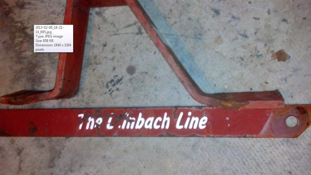

Thanks guys. I have some 1/2" milde steel plate that is around 8x10". I think I'll lay that on the ground (shock absorbsion) and see if I can straighten the spring.
Although I think it should be fine with grade 2, given that the tines will only run along the surface, what bolts would you use at the cap that holds the springs on?

Normal grade 5 is plenty and probably more than original. Go with that.
You might have a hard time swinging with something along the ground. Maybe try a big rock and pound against that. Just pound them sort-of flat but it will come out fine if you use a BIG hammer. The bigger the better and if you can swing a light sledge with one arm, do it. Wear goggles and keep us posted.

I was able to bend the inner cultivator spring relatively easily with an 8-lb sledge, with the spring on a 2x4. Thanks for the suggestions! However the outer spring must be a different metal, because I could not do a thing with it. I think I may gently push down on the bent area with tractor FEL.

Sometimes when you hit something and aren't holding it the energy transfers in some way and the metal just bounces. I usually wear a glove to hold it and whack it in on a flat anvil and flip it over a couple times. I can't recall one I couldn't straighten. It's sort of whatever works but be careful with the loader. There's a lot of force there and you don't want to overbend it. Maybe try to find a friend with an anvil.

Thanks for all the replies! I did get the tines straightened. Time for another project!
This time around it's a 1-bottom plow. In its previous life it suffered a bit of wear (bends). I'm not sure how to fix these 3/8" thick brackets. hmmm. it also has a couple of 3/8" x 3" angle iron brackets that are bent, but those I can faily-easily reproduce from new angle iron.

:thumbsup: A couple of HF cheap 24" adjustables with 6' extenders is the tool to have. Put the tractor tire on it to hold it down or use loader against a firm surface, cross the wrenches and have at it making small corrections til youre done. Then change ends and do it again. No heat or prayer necessary.
