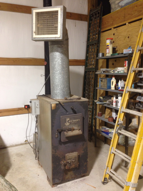

This is what I use to heat my insulated shop.
I bought it used 10 years ago, and have about $300 invested between the wood burning furnace and chimney pipe. The squirrel cage blower really moves the air...which is good and bad. Good because it circulates the warm air, bad because the cold air runs across the floor back to the stove. :)
But once she's got the shop warm..it's all good! My shop is 42' x 68' with 14' sidewalls and open trusses - 21' at the peak.
I would NEVER be able to warm the space if the building wasn't insulated. Oh I would have warm air blowing on my head, but my legs and feet would never warm.
If you can - insulate your space!!!
