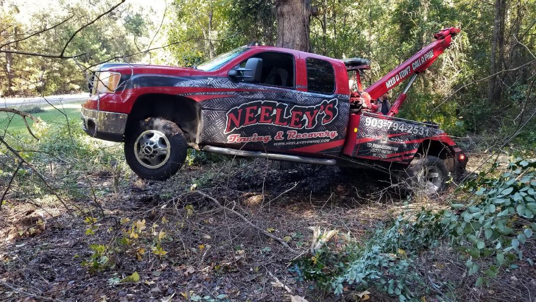

Well I'm glad I decided to rent a skid steer to try out. I rented a Kubota 95 hp with tracks. I bought a used Bradco heavy duty brush cutter. After 2 hrs I got stuck up to the tracks.
Yes it had rained lightly over the last week but I thought the tracks would handle it. I have too many low spots on my 45 acres to risk a heavy skid steer.
I now have the Bradco brushcutter up for sale.

What the heck is that tow truck doing? Lol
