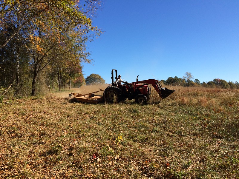

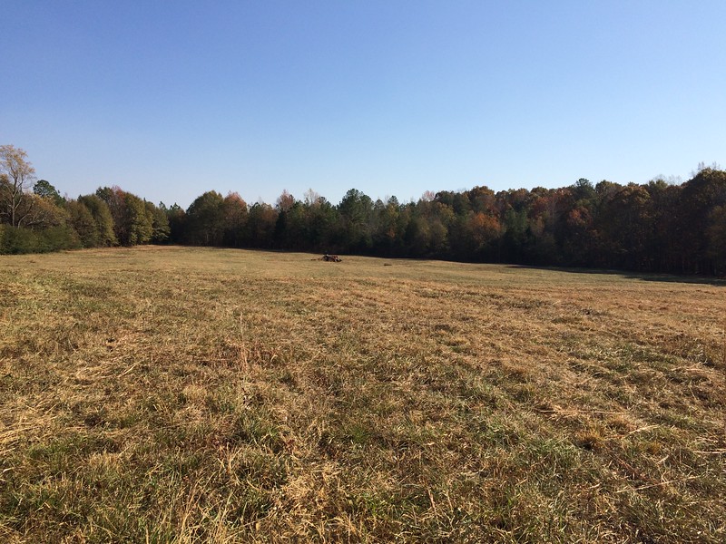

Hello everyone....here is what we purchased. I have had the fields cut and the guys cutting them have used 2wd tractors with 6ft bush hogs. Takes them about 5 hours to cut everything. I do want a FEL/4wd.
17 acres total....frontage road to the rear tree line. Tree lines on side define side property lines.
4 acres front field is slightly angled towards the woods away from the road.
5 acres of hardwoods..gravel driveway will go through the woods to connect road to back field.
8 acres back field is flat
Might get a cow or 2 but we will for sure be getting a donkey(s).
Let me know your thoughts.

Presuming you will be happy spending five hours mowing your land with a six foot Bush Hog, however many times per year, you need a tractor of 45-horsepower gross. If you want to pull a wider Bush Hog, or cut unusually long grass, you will need more horsepower. Tractors in 45-horsepower to 60-horsepower range weigh 4,000 pounds bare and are about 66" wide.
A wider mower will preserve your time for other tasks and be somewhat more fuel efficient per acre cut.

With full 10' tall garage doors, you should have no trouble with any tractor up to 70 HP fitting inside. From the one photo of the man bush hogging, it doesn't look like you have anything very thick to deal with so 40 HP PTO should well handle a 6 foot bush hog even if it is tall grass.
